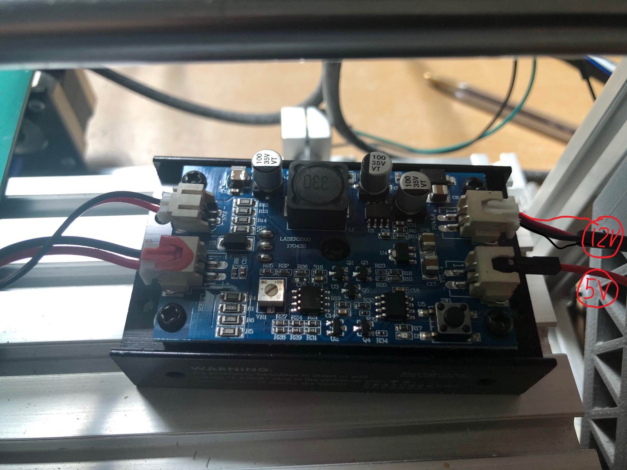

I am using a TTL laser from Bangood. See the link below.
I connected the laser TTL module to the Control board of 3018 CNC Router and power it with 12V from an external source. The laser is always on. It did not work, so I just create a sketch in Arduino and connect a multimeter to see the voltage and it could be 0-5V but the laser is ON all the time.
How can I turn it off and on from the controller?

There are specific changes needed for laser use under GRBL.
First off you would need to upgrade to GRBL 1.1 which has better laser support.
Then the laser will normally use SPN EN (spindle enable) pin and ground and it can be PWM'd via the spindle speed so for example G0 S0 would be laser OFF and G0 S255 would be full power.
That last number can vary depending on the max spindle speed set in GRBL so if you normally have a spindle capable of lets say 1,000 then 1,000 and set to that in GRBL then 1,000 would be full power and anything between that and zero would be incrementaly lower 500 being 50%
