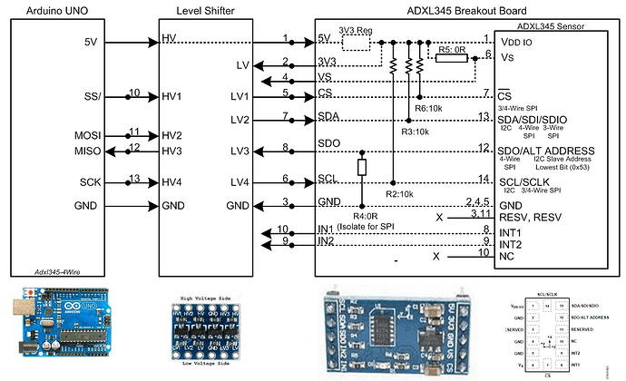

1. Introduction
The ADXL345 3-axis accelerator sensor supports I2C Bus, 4-Wire SPI Port, and 3-Wire SPI Port operations. However, the Breakout Board (Fig-1) has come up in I2C Mode. To operate the Breakout Board in 4-Wire SPI Mode, the R4-register has been isolated carefully using a sharp tip of a 60W soldering iron. The filter and storage capacitors of the Breakout Board are not presented in Fig-1.
2. Physical view of the Sensor is presented in Fig-1.
3. 4-Wire SPI Connection Diagram (Fig-1) among Arduino UNO, Level Shifter, and ADXL345 Breakout Board.
Figure-1:
4. Test Sketch to read the Device ID (0xE5) of the Sensor
#include <SPI.h>
SPI.begin();
SPI.setClockDivider(SPI_CLOCK_DIV16); // 1 MHz speed
SPI.setDataMode(SPI_MODE3); // Set SPI mode (SPI_MODE3 for ADXL345)
SPI.setBitOrder(MSBFIRST); // MSB first
digitalWrite(SS, LOW);
delay(200);
// Put ADXL345 in 4-Wire SPI mode
SPI.transfer(0x31); //DATA_FORMAT Register in single byte write mode
delayMicroseconds(100);
SPI.transfer(0x0B); //data for DATA_FORMAT Register
//Reading device ID (0xE5) to be sure that the 3-Wire SPI Port is working
SPI.transfer(0x80); //DEViceID Register in single byte read mode: 10 000000
byte devID = SPI.transfer(0xFF);
Serial.println(devID, HEX); //expecting E5; but, shows: FF
delay(2000);
5. Output
E5
E5
E5
