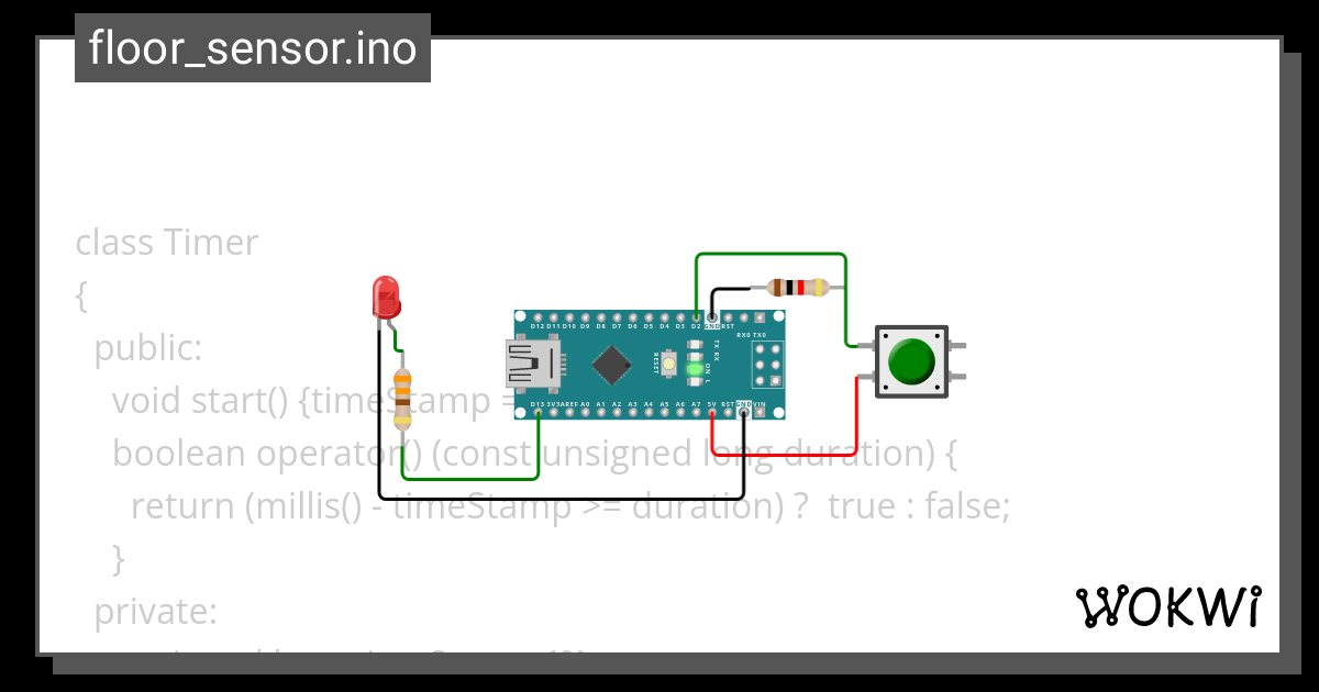

Here are two links to a code simulation.
Because I don't know what kind of sensor you are using, I used a push button to generate a HIGH signal.
The second version of the programme is not blocking. This means that the controller can do other tasks while the sensor signals are being processed.
The programmes are designed in such a way that when a HIGH signal is present, the LED is switched on after 10 seconds. It remains on as long as the HIGH signal is present. If the sensor signal goes LOW, the LED is switched off after 10 seconds.

im using a floor sensor for industrial vehicles, the purpose of this system is
when the driver must work on the station he will put the carrier over the loop, then 10 seconds later a STOP signal will turn on on the corner, but if a driver just pass over the loop, the loop shouldnt start a counting, i mean, it will count just when the carrier is present, when is just a pulse, wont.
Maybe like this?
The button is not debounced. But that should not matter with the time spans.
Edit: Transferred the source code from Wokwi.

yeah! count just when the sensor is HIGH, but when the sensor is LOW after the light was on must wait 10 seconds before turn off, like a traffic light.
