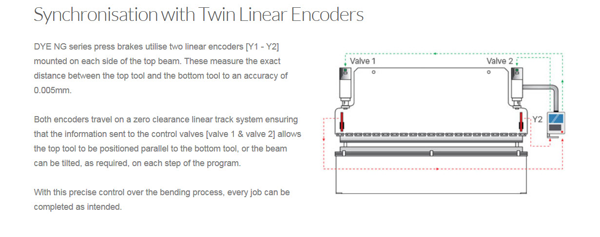

How did the original setup achieve parallel operation?
How did it monitor each cylinders position?

If you think it about the press has everything to control level electronically. Originally was cnc press.
It still has 2 sliding encoders on each side and it has proportional solenoids valves control.
Just need little brain to take signal from 2 side encoders and then control via relay proportional solenoids valves.

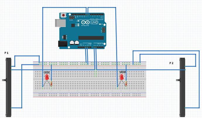

See the attachment electrical schematic of the balancing controller.
Basically I need to write a program to compare 2 analog inputs from 2 potentiometers connected to a Arduino and show me the difference on one LED (relay) also connected to the same arduino.
There is the logic plan how that should works
P1 is the main master potentiometer
P2 potentiometer should always match resistance to P1 by switching off and on LED 1 and LED2.
LED1 and LED2 its relay which control proportional solenoid valves.
When is no difference in resistance between the 2 analog plus minus 5% two LED should be ON
When is the difference in resistance on P2 is < then 5% to P1 switch LED2 and LED1 is off
When is the difference in resistance on P2 is > then 5% to P1 switch LED1 and LED2 is off
Have you any advice about the code please?

What I need just switch on and switch off servo control solenoid (left side right side) if difference 0-10% on potentiometers was detected. I will attach linear potentiometer to each cylinder to read there position. I have a dual pedal switch for up and down.
For now I also have installed limit switches for depth controls.
The press has original Linear encoders but not sure how to connect to Arduino.
I attached picture how cnc press works.
