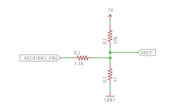

Ok. It is easier with that driver board because Vref is brought out to a regular pin. From the Pololu instructions the current limit is given as 2.5 times the voltage at Vref.
Are you able to calculate a voltage divider that will give the two current settings you require from a 0-5V Arduino pin?
So I am not very familiar with electrical engineering calculations. (I am a chemical engineer)
I do know that I need one setting to be the full current supply and the other to be about 1/8th of the full supply.
Please tell me how many amps you want for "full". Note that it is not a good idea to go to the absolute maximum rating of the A4988 as that board doesn't have enough cooling.
I have a 9v 1amp power source, powering two drivers in parallel, So full would be about 500 milliamp
So for 500mA, you need 0.2V on that reference pin. For an eighth of this (62.5mA) the voltage should be 0.025V
If you can desolder the adjustment potentiometer, this will be a lot easier. We can drive the pin directly. Use the circuit below.
If you can't desolder the pot then try the circuit without R1 and adjust the pot until you get voltages close to what you want. I suggest that an eighth is probably too low. You may want your holding current higher. In that case, change R3 to 3.3k and R2 to 100 Ohms. Increasing R3 will reduce the difference between high and low current modes. Increasing R2 will give overall more current. Experiment with it!
