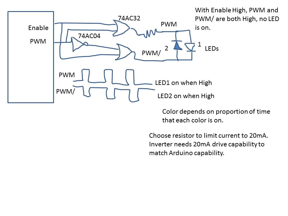

Does anyone know where I can go to get info on controlling a 2 wire multi color led, the type found in cheap solar powered lawn ornaments such as the ones sold at Harbor Freight.
Connect it to two output pins, with a current limit resistor, like 270 ohm.

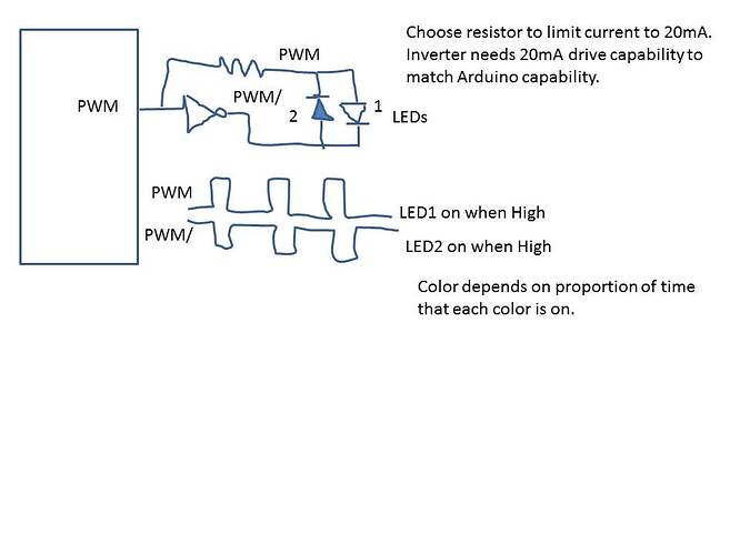

Thank you for the reply. However it is multicolor, about 5 or 6 different with one fading to the other. Sorry I wasn't clearer at first.

Course, if you want to turn both off, will need a way to 'gate' the PWM output to achieve one of the off states.
Microcontroller does not have a way to achieve sync'ed inverse PWM that I am aware of hence the need for external hardware.
Other method is to control 2 outputs using blink without delay style programming.
Do not power it with more than 4 or 5 volts at most - through a resistor.
If you have specs on it - always the best way - follow them carefully regarding current limiting and voltage. Because the colour is changing, it does this internally using PWM and if you are driving it with too much current or too much voltage, it is quite easy to overheat them and they can have a short working life.
