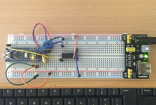

I feel like I am either missing something simple or being incredibly dense...or both! I have pared things down to the minimum configuration applying what I think I was told to do above and it still does not do what I want it to do!
Here is the wiring diagram and a picture of the actual breadboard:
Here is the sketch:

I can see the voltage oscillating on pin 12 but it never changes on the output side of the ULN2003A.

Nor will it. In this situation, you are doing wrong, exactly what we thought - you are connecting the laser to ground instead of to the +5 V supply.
Is this by the way, the laser you intend to actually use? If it is, and it has mounted on the back of it a resistor marked "910", then it should be safe to connect it directly between pin 12 of the Nano and ground.
I mention pin 12 rather than pin 13 as pin 13 already has a LED connected and drawing power. The laser specified with the "910" resistor on the back will draw 25 mA or less and the Arduino can actually handle three or four of them directly connected to different pins - but no more than four.

Ok.......first, thanks for everyones help on this. I really thought that I was being dense but in reality I was also careless.
I had actually tried hooking the laser up every which way from Sunday. I did miss interpret what I was told above, as you can see from the diagram and picture, but I had also tried it the right way and that had not worked either!
Why you ask?
BECAUSE THE ULN2003 WAS NOT PROPERLY SEATED IN THE BREADBOARD!!!!!!!!!!!

The Nano also seems to be (under)powered through Vin :frowning:
