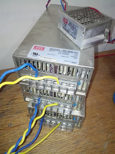

Here's my setup 3x 24v power supply for Solenoids |375x500
24 board to drive 192 Solenoid, Each one have 8 output. connected to each other with a 20cm connector. |500x375
Control signal is coming from Arduino Uno board right now, connected to the first board with 4 Meter of Ethernet cable.
