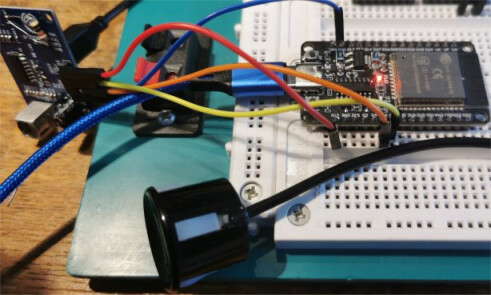

this is an example using ESP32 serial reading distance from a jsn_sr04m - may give you some ideas

serial monitor output displays device information then distance to objects as I move the sensor around

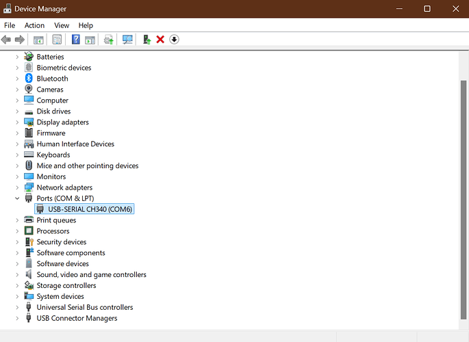

Hey @horace so I tried your code switched the COM to my respective port.
serialPort = serial.Serial(
    port="COM6", baudrate=9600, bytesize=8, timeout=1, stopbits=serial.STOPBITS_ONE
But I still get the inconsistent data I believe it might be a faulty sensor or a faulty set up

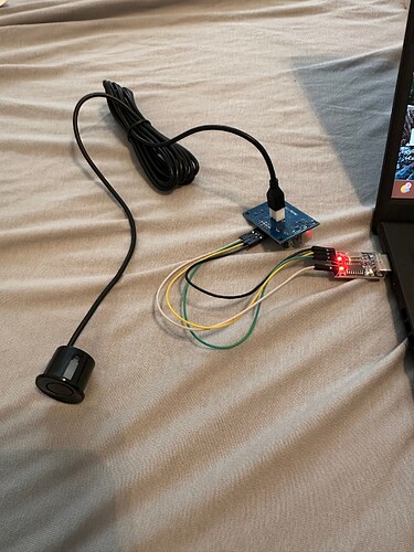

Here is my set up I have the sensor connected to the usb using wires connected to TX --> RXD and RX --> TXD. I also have the sensor on mode 5 per this forums instructions.
How to Communicate Waterproof Ultrasonic Sensor AJ-SR04M/JSN-SR04T with Arduino/ESP32 – Probots Blog
Is there anything I'm missing or anything going over my head. I'm not sure if it's the sensor or something I'm doing wrong. I tried it using a raspberry pico w and it worked so I don't believe it's the sensor. Any help is appreciated. Thank You all who have contributed

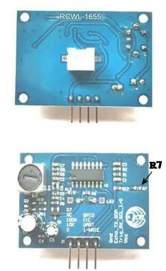

the sensor I am using is labeled RCWL-1655
I soldered a 10Kohm resistor across the R7 pads to enable the UART
I understand that there are different versions of the jsn_sr04m - the one I have uses a 24bit distance (3 bytes) but there are 16bit versions and 24bit versions which use 4byte (3data+checksum)

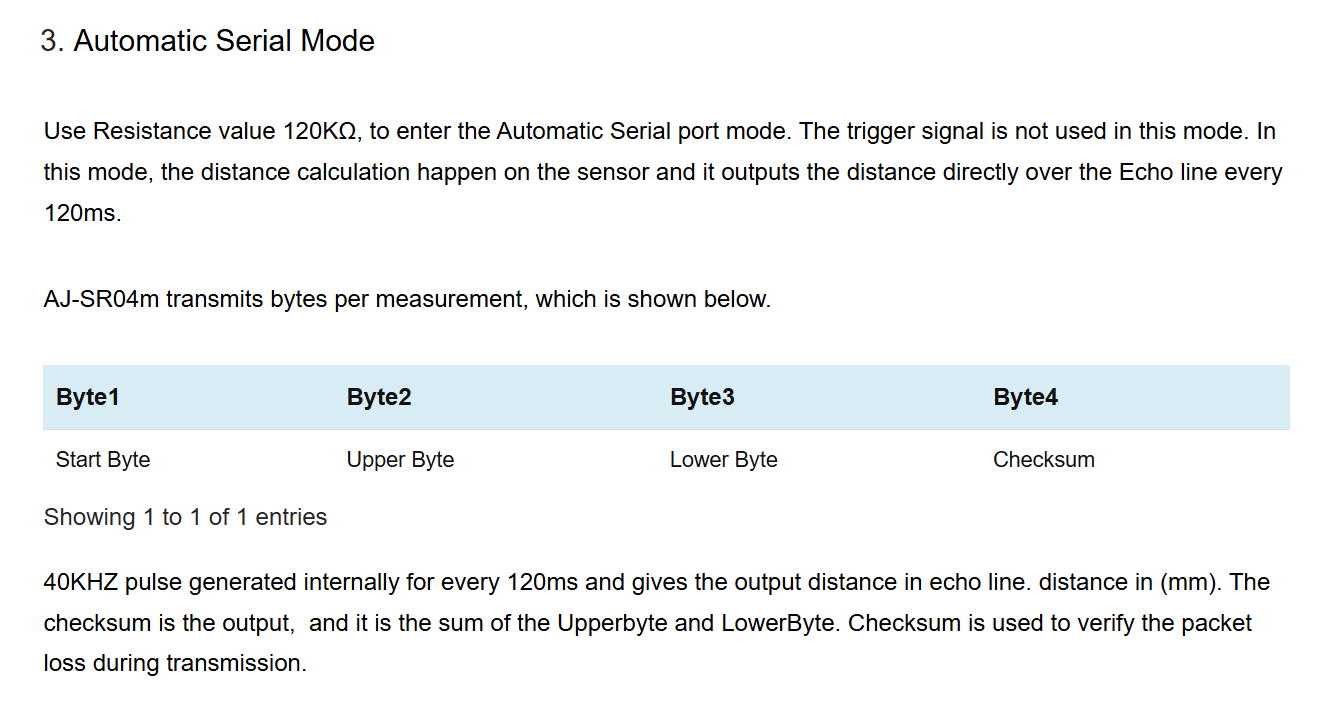

Here is the datasheet/manual for the ultrasonic sensor. I'm using. ARDUINO AJ-SR04M Distance Measuring Transducer Sensor User Manual
I short circuit the R19 to get Mode 5: ASCII Code output (Minimum Power Consumption 20uA)
clearly your jsn_sr04m is different from mine
the document referenced in post 16 does not mention the serial format
it is probably 3data bytes + checksum
possibly you read a block of four bytes, calculate the checksum and if it is correct you have the distance if not discard first byte and calculate again
