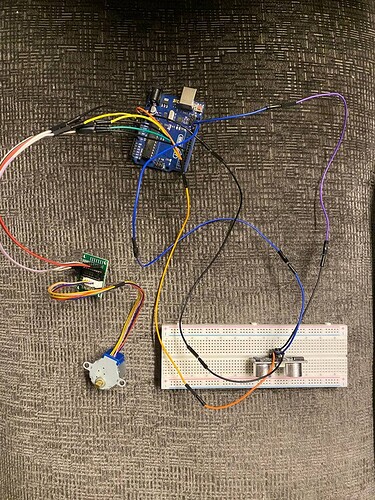

Post a wiring diagram of the project. Written descriptions are always more ambiguous than a drawing. Hand drawn, photographed and posted is fine. Include all pin names/numbers, components, their part numbers and/or values and power supplies.
Post a diagram showing the mechanical setup so we can know how it will work.

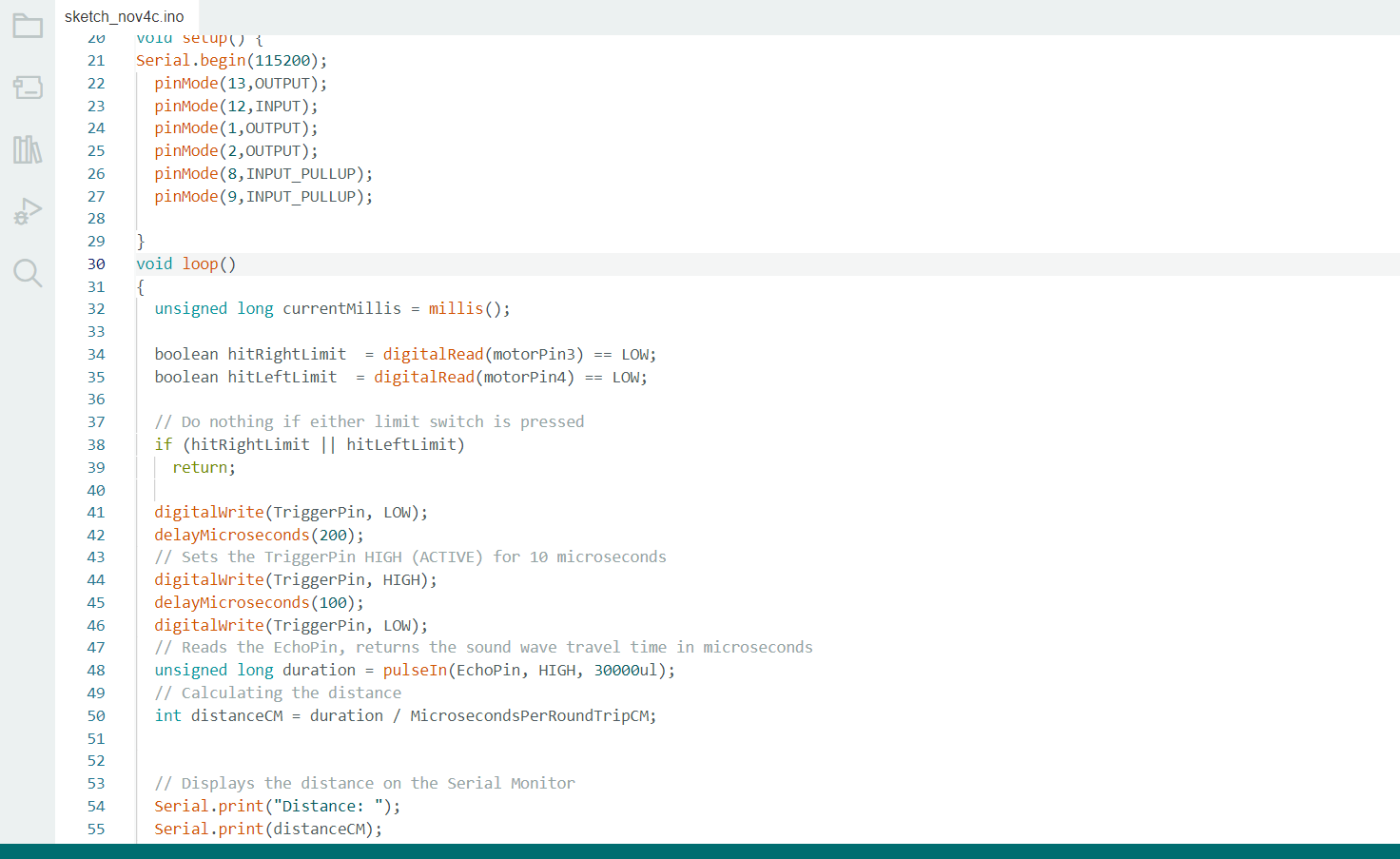

Images of code are nearly worthless. I cannot copy the code to a text editor or the IDE for examination or verification. Please read the forum guidelines to see how to properly post code and some information on making a good post.
Post the complete verifiable code.
Use the IDE autoformat tool (ctrl-t or Tools, Auto format) before posting code in code tags.
So where is the diagram showing that system that you were requested to show in post #3?

this is the system i just want to control the stepper motor with the ultrasonic sensor in certin distance the stepper motor start working
Why is it so hard? The forum guideline tells how to post code. I, for one, will not download code.
Posting the same photo again does not clear up our questions.

hi i'm new using Arduino Uno
I have question about my project if u can help me i will be thankful
I'm using (28BYJ-48) stepper motor with uln2003 and Ultrasonic Sensor (HC-SR04)
my plan is to control the stepper motor using the ultrasonic sensor.
if the distance is more than 15 cm, it should moves to the left
if the distance is less than 15 cm, it should moves to the right
this is to move belt in my project
the ultrasonic works perfectly but the motor vibration without moving
could you guys kindly check my program and help me with this issue?

Can you write (or find) some simpler code to verify that you can actually step the motor?
the only working in my code is the Ultrasonic the motor just vibration without moving i dont know why
Because you don't step it correctly. You have four motor pins, but you step only one of them.
Why not using a library? It's much more easy - especially with this stepper. This is not a step/dir driver/stepper.
?it can be done without driver/stepper control circuit
I don't understand what you mean. You always need a driver for your stepper. Arduino cannot control a stepper motor without a driver.
