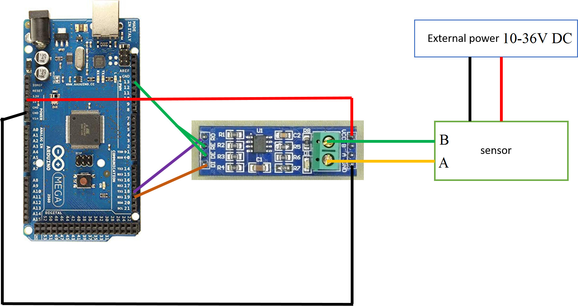

I also found a potential wiring diagram in another post: Reading Sensor values digitally with RS485 - Science and Measurement - Arduino Forum
Could this circuit be good for my Uno?
And is it OK if my sensor requires (as I understand) 10-36 V supply?
I mean, it will now be through this MAX485, but is it still safe for Arduino side?
