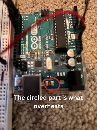

Hi, I am stumped on how to fix this issue (I couldn't find stuff online and nobody I asked could fix it). When I plug my Arduino into my computer, the gold colored chip labeled "S04L" (circled in the image below) starts to massively overheat.

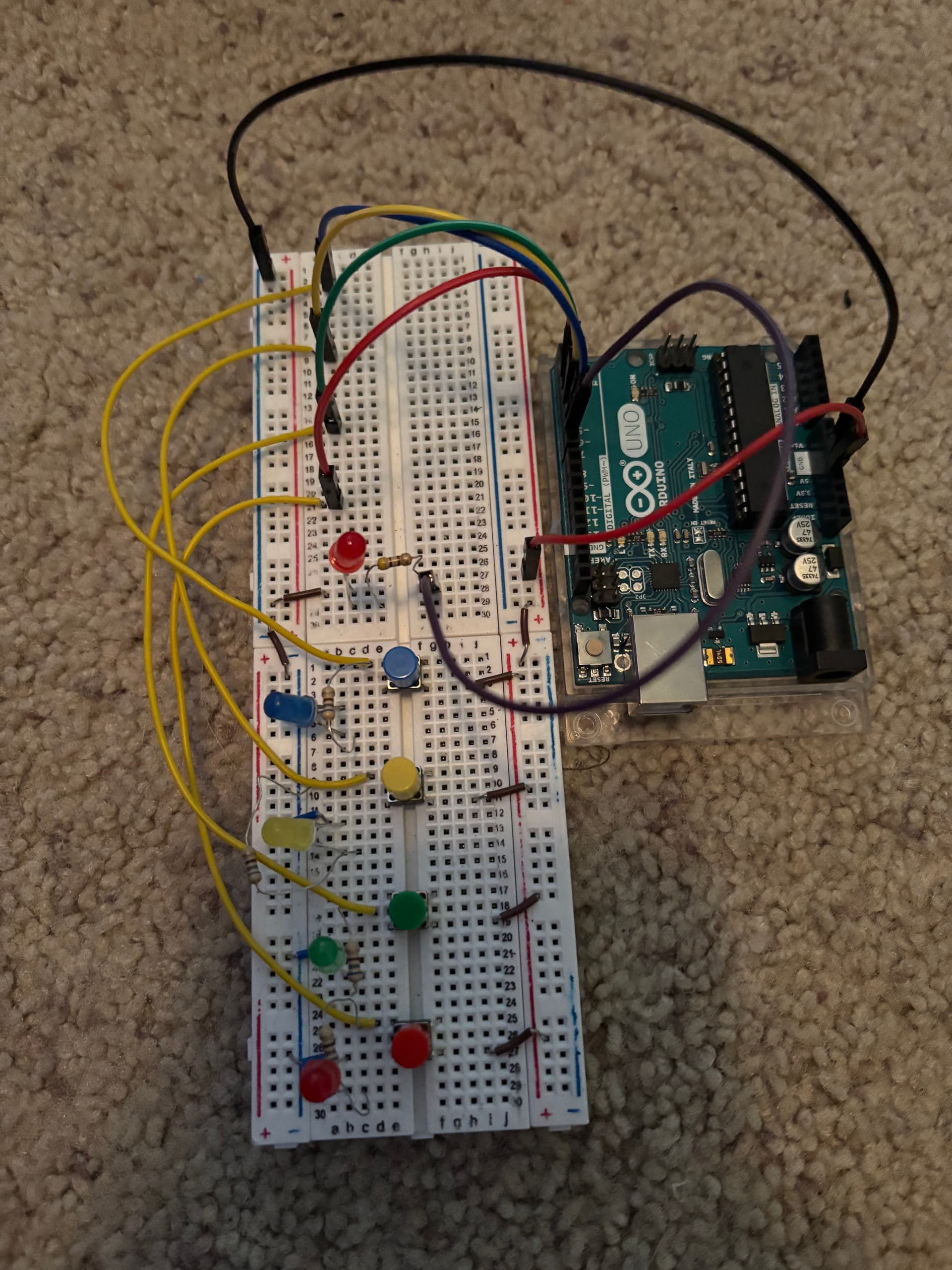

Real life circuit:

Left to right:
Ground connected to the left side of the pushbutton.
Left side of the pushbutton is the same connection as the right side of the pushbutton.
Right side of the pushbutton connected to 5V.
Dead short between 5V and ground.
Any questions?

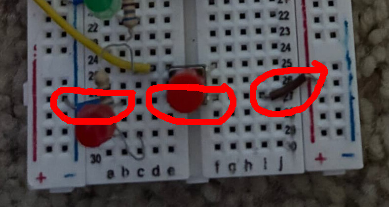

The LED and resistor aren't quite touching (and I moved them aside anyways). The Arduino still overheats and won't let me upload code
Did you read what I wrote? Did I mention the resistor or LED at any point?

Look at how the tactile switch is configured with the contacts.

You have one side of the buttons connected to +5V, the other side connected to I/O pins. Are the I/O pins set to OUTPUT and LOW?
Thanks to everybody for your comments! I took another look at the circuit and realized that (not in the close-up picture above) one of the push buttons had been moved, creating a short. I really appreciate your putting the time in to lend me a hand. Thanks again!
If you are lucky, the thermal fuse did its work to protect your arduino....
After cooling, it may work again...
