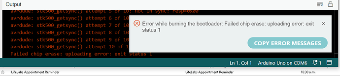

Burn Bootloader fails.
Did you upload the File > Examples > 11.ArduinoISP > ArduinoISP sketch to the Uno before attempting the "Burn Bootloader" operation?
OOPS! corretion to me.
I neglected this: " select "Arduino as ISP " from the Tools > Programmer menu."
Your solution worked. Thanks, again.
