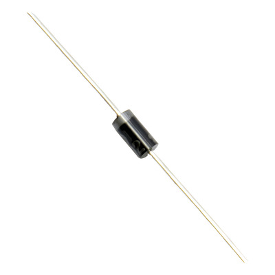

  • Suggest you use two series silicone diodes, can’t get much lighter. :thinking:

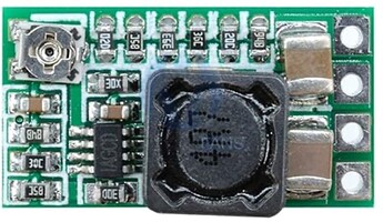

A buck-boost regulator is a switching regulator which can regulate up or down... To a point, it could put-out 5V even when the battery is below 5V. And switchmode operation means that it the transistor or MOSFET inside only "sees" voltage or current at any moment so it dissipates and wastes very little power. (The output is filtered DC so your circuit doesn't see the switching.)

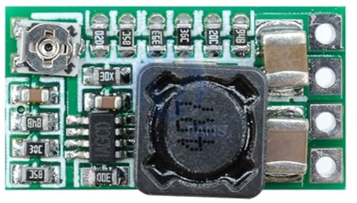

  • A Buck Converter (~ $2.00) is a small lightweight voltage regulator; has all the necessary components on its PCB.
    Their efficiency is such that a heat sink is not needed.
    You usually set the output voltage (ex. 5v) which needs to be less than the input voltage.
  • A Boost/Buck converter is similar.
    It can boost a low voltage OR reduce a higher voltage to a set point output voltage.
  • Two diodes is a reasonable solution for this application. Each diode reduces a higher voltage by about 0.7v.
    If your battery is 7.2v the two diodes gives you, 7.2v - 1.4v = 5.8v, most hobby servos work from 5v to 7v.
    A 1N4007 diode is about $0.50

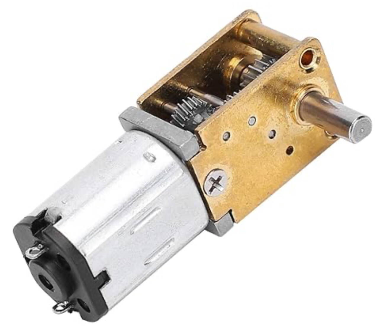

Now that I think about it...a solenoid would simplify things greatly. The only potential issue I see is possibly weight? The design I have right now requires two pins to be pulled simultaneously (this is a function of the materials, dimensions, and overall geometry of the nose cone). The lightest solenoid I've been able to find so far is 12.5 grams, which would be 25 grams for two. The servo method then saves 20 grams, but there are likely lighter solenoids out there that I haven't found yet.

Probably not. The servo has a geartrain inside that increases the torque. A solenoid with the same "torque" as the servo will always be heaver. Stay with the servo,

I'm inclined to believe that for a given force and distance, most solenoids will be significantly heavier and more power-hungry than a small hobbyist servo motor. (the servo is slower...)
You MIGHT be able to get a very carefully designed solenoid (mechanical and electrical) to work better (and simpler) at the same weight as a modern micro-servo, but I think it would be a lot more work.
You ought to be able to get 1n400x diodes for a lot cheaper than $0.50.
Digikey's price is $0.10 each (q1 - $0.73 for 10), and I once bought a box of 1000 (?) for a ridiculously low price (want some? If you're in the US I'll mail some to you if you PM me an address.)
