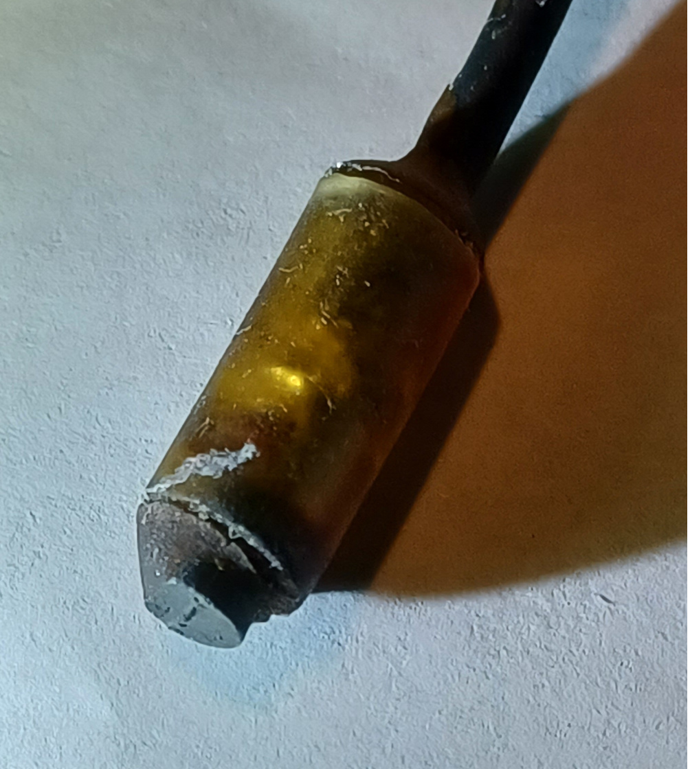

When I used a TO-92 sensor decades ago I connected the cable and then embedded in epoxy. I used a small section of a straw to contain the epoxy until it cured. The tip of the sensor can be seen outside of the epoxy. There is a "waterproof" heat shrink tubing that could be put over the embedded sensor for additional protection.
Realize that any of the "waterproof" sensors that are directly exposed to water will leak eventually.
