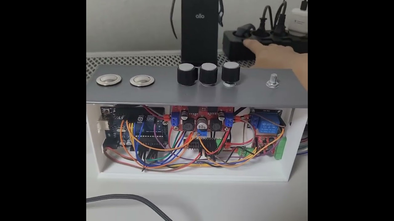

Hi all! I made a 10W LED Color and Brightness controller for my own use. despite it works well, there's a problem.
I use 12V SMPS to power LED module, and when I turn on SMPS, at that instant, LED turns on and off very quickly.
despite I added a relay module to solve this problem, but it seems like that both NO - COM and NC - COM are short when module is not powered with 5V VCC.
(1) Why this happens?
(2) How Can I prevent LED turning on right after supplying 12V input, and before arduino is on?
[video]
[schematics of project]
[arduino code]

thank you for answer! but after adding
digitalWrite(RELAY, HIGH);
on the first line of setup() function, still there's very short LED Turning On moment.
so I think it's a problem with the order of power supply. which is...
(1) SMPS turns on, and LED driver and buck converer is powered with 12V. arduino is power off.
-> LED Turns on
(2) buck converter starts to power +5V to the arduino and LED driver module.
-> LED Turns off.
Is there any way to power LED driver's +12V input AFTER 5V input?

  • Try adding delay in setup( ) to give time for things to settle down at power up time.
Yes but it would easier to delay the control signal to the relay.
I can't tell from the picture is a Relay Module with HIGH level trigger?
Then the very first two lines in setup() should be
pinMode(RELAY, OUTPUT);
digitalWrite(RELAY, LOW);

thank you for all the answers. I've tried those on post #2 and #5, but not worked.
Here, NO - COM is connected when relay module is triggered with HIGH logic sivnal.
I used ohmmeter to the relay module, and figured out that my relay module connects all 3 pins (NO - COM - NC) , when it is not powered with 5V VCC.
(1) Is this how a relay supposed to work? I thought that a relay is sort of mechanical switch, operated by electric signal. and when not powered, one of 3 pins is not connected to the rest 2 pin. should I look for another relay module?
(2)
Any other suggestions? fixing arduino code won't make it, as this "flashing" moment is even before arduino makes logic level signal.
I have not told you how to do it, so exactly what did you do?
No, if what you say is true then that module is defective.
Buy a new one
but check before, if some part you can replace, or may be it is soldering issue
↓ I mean, this.
I think I should buy another relay module, then.
but is there any other way to solve this issue, without using relay?

What are those constant current drivers you are using?
Are they Sparkfun femtobuck?
I would invert these two commands.

The relay is broken and is of no use or even necessary. Anything in the code relating to the relay can be eliminated.
Well if interested, I'll be off and on for a few hours.
Just meter probes - nothing else (wiring) ?
This is the LED driver I used for this project.
I didn't understand what your suggestion means. Can you give me some more about your inquires?
You posted that you made some resistance measurements.
In response I asked whether there were any wires connected to the relay terminals (C, NC, NO) when you did that.
