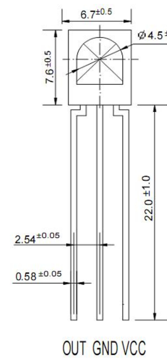

The data sheet is here. It uses a 38KHz modulation frequency.
https://www.sivago.com.cn/upload/pdf/2022/VS1838B.pdf

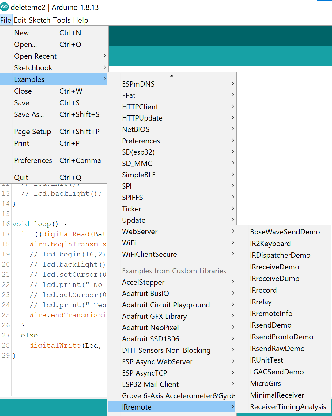

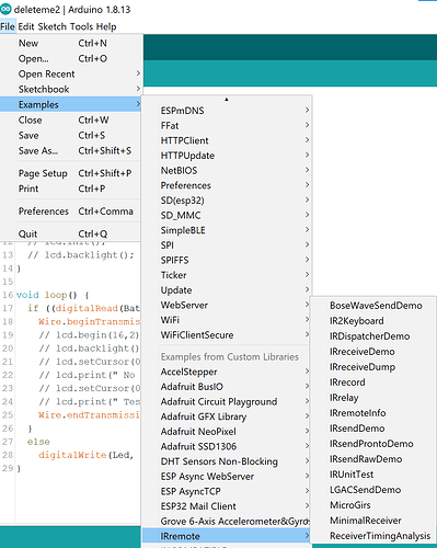

so wait im kinda new to arduino how to i find example sketchs?
After installing the IRremote library, there will be examples like this:
I'm using an old version of the IDE. If you are using IDE 2.x.y then the UI may differ from my screen shot, but you should still be able to find the examples in a similar way

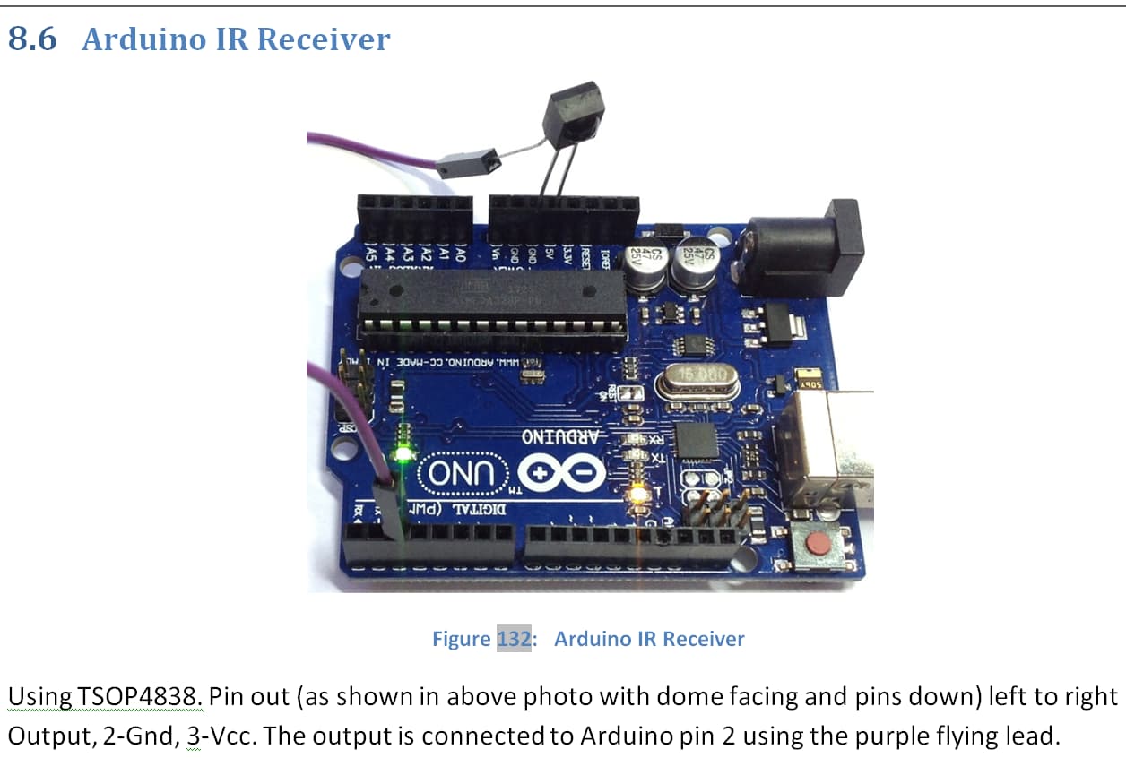

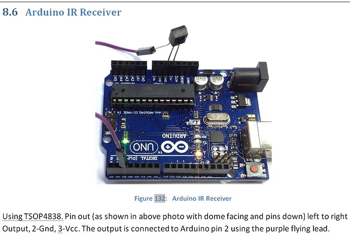

This is how I wired mine:
Assuming the datasheet in post#4 is for the receivers that you have, then the pin out should be the same as the one I used. This screen snip is from that datasheet:

Your code expects the output pin of the IR receiver to be on pin 11
Hopefully you didn't wire it to pin 2 as shown in the image of how I wired it up. If you did wire it to pin 2 then change the code to use 2 rather than 11.
If you want further help, please post an image of how you connected the receiver to your Arduino. The picture will need to clearly show which pins of the receiver are connected to which sockets on the Arduino.
