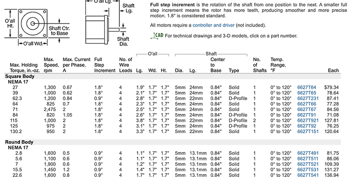

Here's a table from McMaster Carr:

The motors I have are 47mm body length with a 24mm shaft. The coils measure 3 ohms. I have set it up to 0.2V and am letting it run for awhile to see how hot it gets. Once again thanks for directing me in the right direction.
