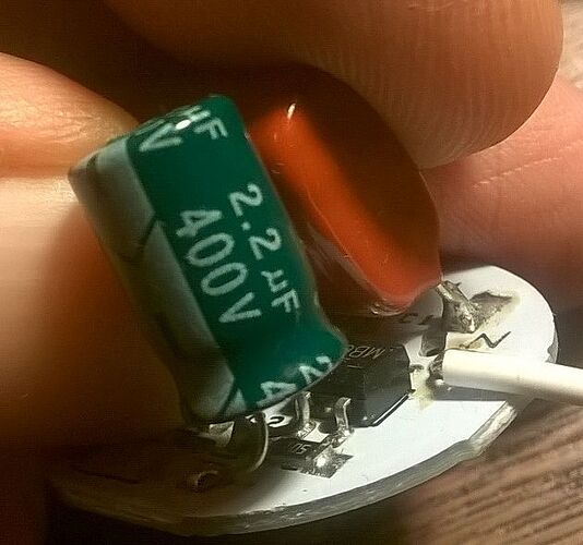

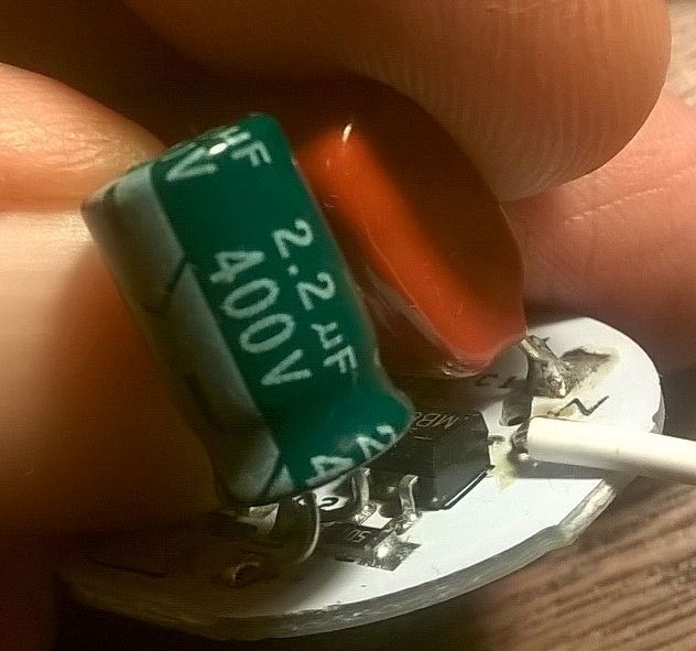

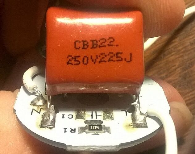

more pics
So there you are - series capacitor provides reactive current limiting, feeds bridge rectifier, 51 ohm resistor limits turn-on surge (but not continuing current) to 2 Amps which is in fact, not applied to the LEDs because the smoothing electrolytic absorbs the surge.

Paul__B:
just learning about how to post a photo into the forum and not just a link.
but, here are two links
and
just shows the cap values and the other resistor.
since I was not trying to repair the light, the old driving circuit was not particularly important.
this was an e-bay special light, non-dimming, got 42 LED's for a couple bux.
