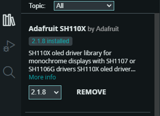

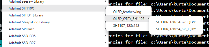

However possibly another option, is to maybe try the Adafruit library: Adafruit_SH110x
I don't know how specific that library is, to their setup, but the do have two examples:
I verified the SPI version compiled.

I had seen the SH110X in examples, Thought it was for SH1106G and wouldn't work with my display.
Thanks again

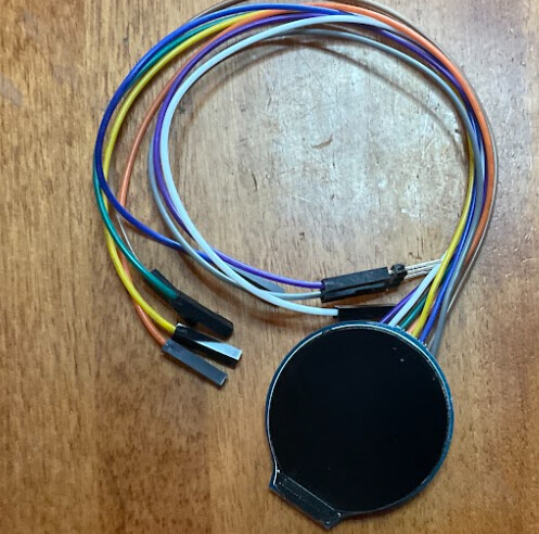

Just some of the stuff I have collected, or probably horded, for testing out stuff, like this. Or for drivers that a few of us like, @Merlin513 and myself have worked on, like probably one of the last ones, we played with:
Which is a GC9A01A

Oops! I didn't say did I? Yes it worked perfectly.
