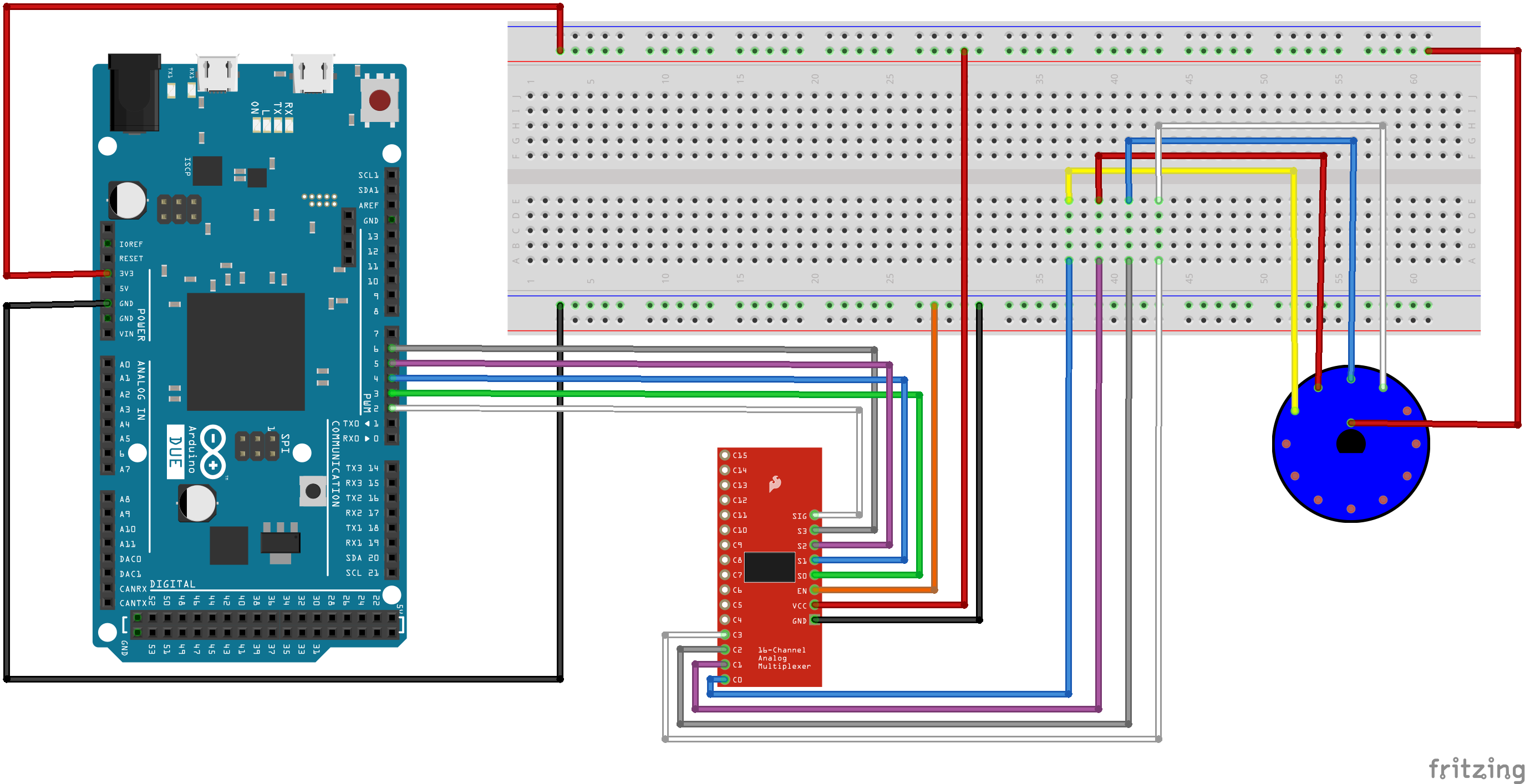

OK - this is my updated Fritz - I've added 10k pull-down resistors to the four Cx inputs I'm currently using and a 200 Ohm current-limiting resistor to the +Vcc input of the rotary switch.
The 4067 and switch now appear to be working as I'd expect - but does my schematic and values sound/look suitable? TIA, again! :smiling_face_with_three_hearts:
Remove the resistor from the common pin of the rotary switch. It will form a voltage divider with the pulldown resistors and prevent proper logic signal levels
Great, thanks. The 4067 will still be happy with the input current, I assume?
which input current? Controller inputs don't draw currents.
Remove it, there is no current to be limited.
