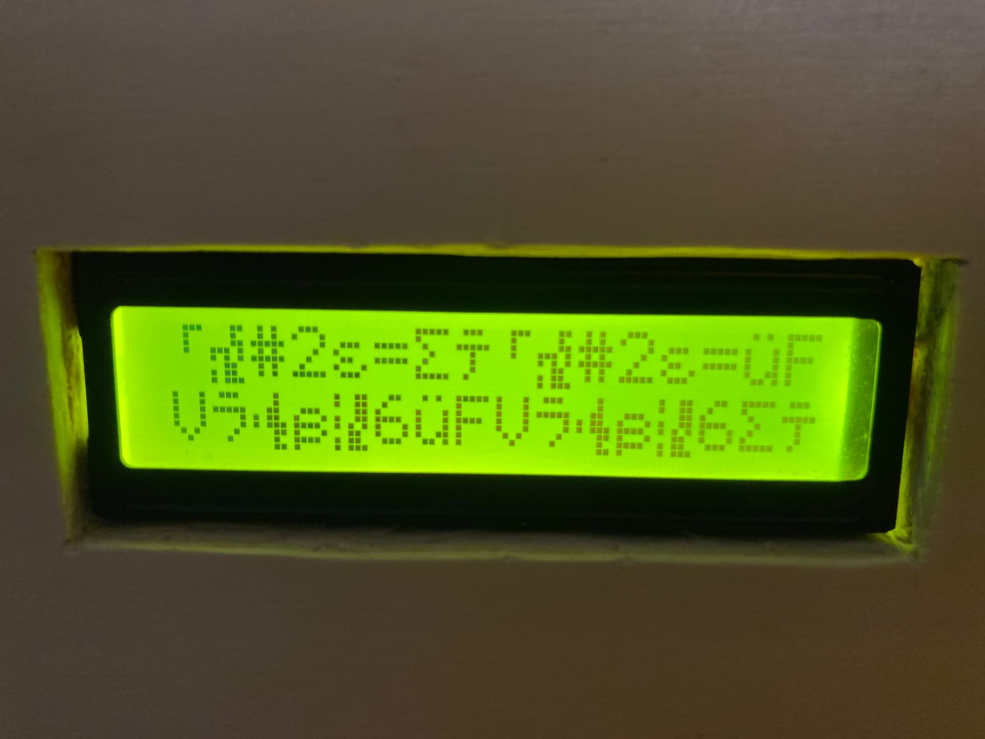

Unusual characters on the display - please help

The problem is I am not at home, I’m in another city and I cannot buy one here. Is there anything I can do to fix it except buying the regulator?

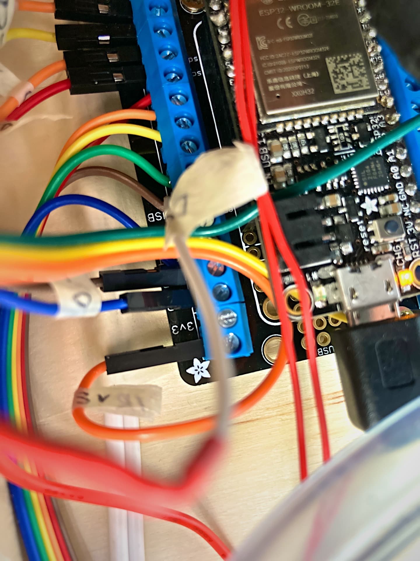

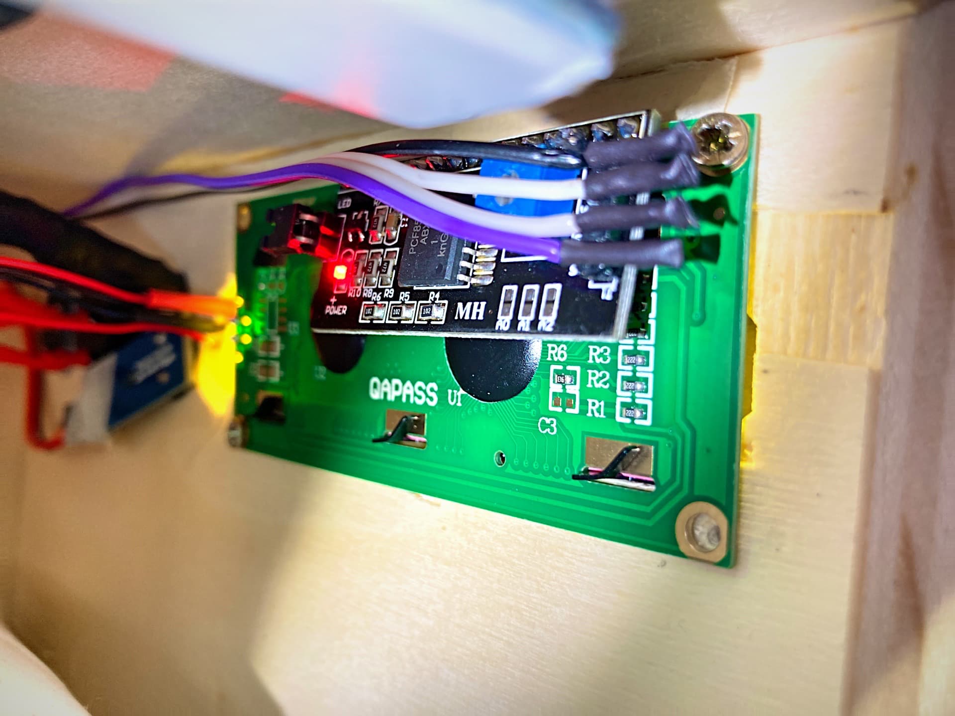

The wires are connected into a terminal block with screws so the connections are good and the LCD came with pins already soldered to I2C from the factory.
Also I just cut the dupont wires connected to I2C and soilder the wires to pins very well, but now the strange characters apear even more often.
The good part is that at least with this new library the image comes back after about 1 minute.
What can I do?
I just found a buck converter into my toolbox, I took an external power supply, set the buck converter from 12v to exactly 5v and connected the + to I2C and the - to ESP ground. Now I don’t see the strange characters that often but they still appear after a few minutes. What may be the cause?
I saw that the strange characters begin on the screen on the temperature sensor value, maybe there is some interference with DS18B20 sensor which also uses the wire library.

Please now post a full details of what this project/code is doing along with a full schematic of everything you have connected and show a few pictures of your project so we can see how things are wired up.
