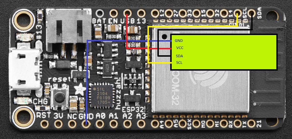

I got an LCD (2x16) with I2C and is showing strange characters when trying to post the temperature from a DS18B20 sensor and a DHT sensor.
I use an ESP32, and the strange characters occur only after about 20 min. or so.
The LCD is connected to 5v, (USB port) since is a 5v LCD.
After restarting the board, the text looks fine for a few minutes, but then the characters appear. What could it be?

The schematic you showed is incomplete.
You only showed the ESP32 and the LCD backpack connections, There appears to be more hooked up to the ESP part. Can you post a photo of your entire setup?
One important thing to note is that you are mixing 3v and 5v logic. This can sometimes work, but typically is not a good thing to do, often has issues, and in some cases can damage the 3v components.
For example the Arduino DUE is VERY fragile. Connect that 3v processor to a 5v signal and you instantly smoke/ruin the processor.
I ALWAYS run 3v processors with level shifters when using 5v slaves.
This creates two i2c buses, a 3v one and a 5v one to ensure that the I2c bus is running at the voltage each entity wants.
i.e. the Master (the ESP board) is running on and connected a 3v bus and the 5v slave (the LCD backpack & LCD) is running a 5v bus.
When you ran the diagnostic sketch it showed that there are pullups on the bus.
The ESP32 boards typically don't have them on the board itself.
Most i2c backpacks have i2c signal pullups on them. The pullups on the backpack are connected to the VCC signal which in this case will be USB voltage which will be close to 5v.
This means that the i2c bus will be running at 5v which is too high for the ESP part.
Luckily the ESP part doesn't seem to fry when this is done.
But it still can and likely causes issues.

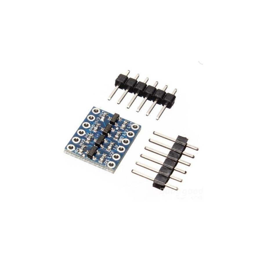

Best thing is to use level shifters to provide signals that fully in spec for each device and ensure that 3v processor is not exposed to voltages that are too high.
Can you run without a level shifter?
You can. I don't recommend it, but if you do, you should run the i2c bus at 3v rather than 5v.
Running the i2c bus at 3v instead of 5v in this case is running the 5v PCF8574 out of spec as it wants to see 5v signals.
While it is out of spec, it tends to work in room temperature environments.
Note that I say "tends to work" because while it tends to work, it doesn't always work and can have issues under certain conditions.
To change the i2c bus to 3v you have to remove the pullup resistors on the i2c backpack. And then add new external pullup resistors to 3v instead.

So while you can potentially clean things up enough to "work", I still highly recommend using level shifters for the i2c signals.
I ALWAYS use them when connecting ESP parts to 5v i2c slaves.
