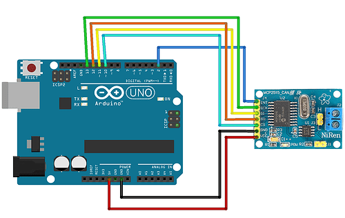

I'm trying out this MCP2515 with a UNO

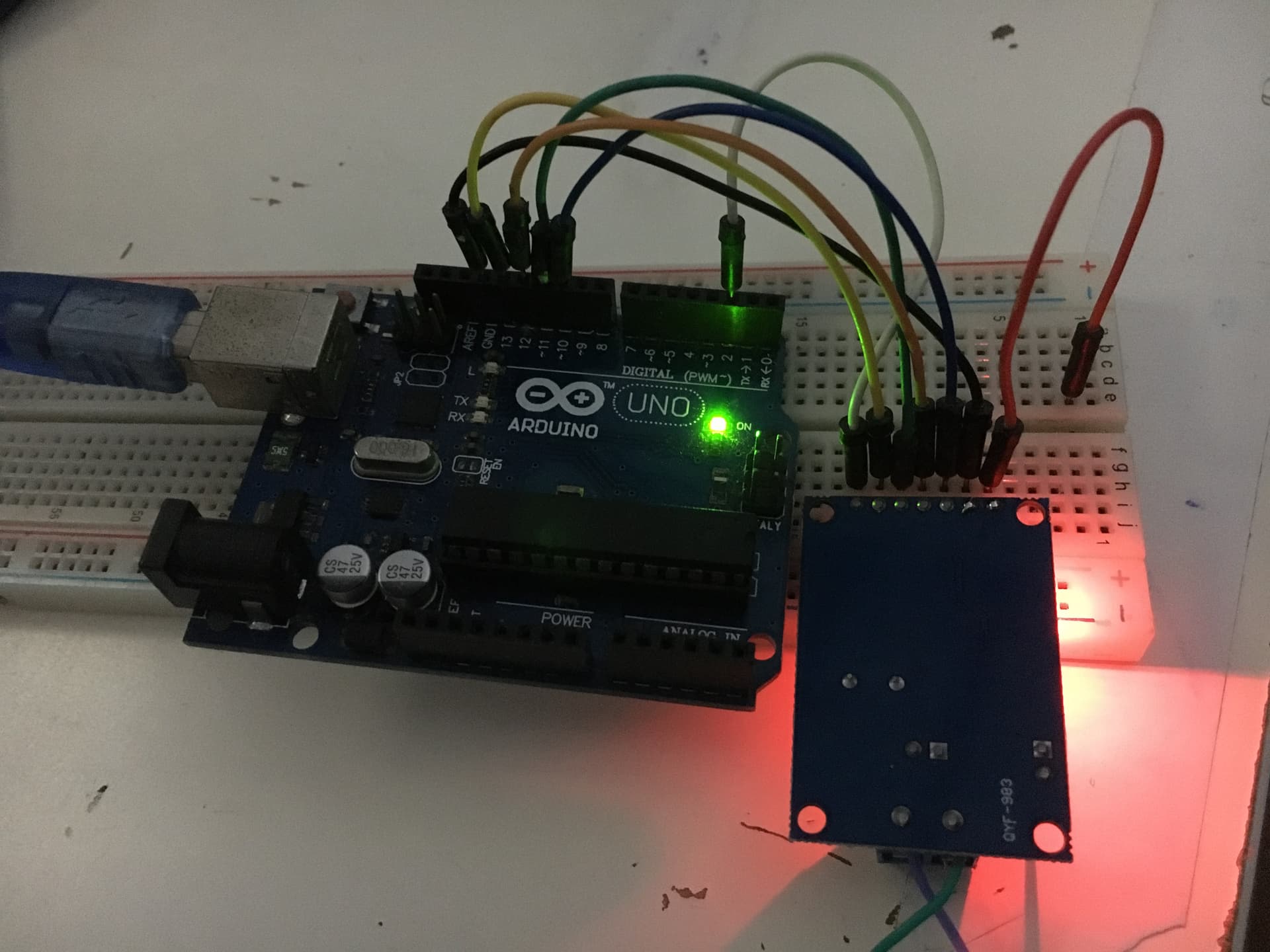

And I'm seeing the MCP2515 module is receiving power without the VCC conenction. See below two images of the actual cuircit.
How is this possible?
Any ideas?
When I disconnect the SCK line, power goes off to the module.
The module is being powered through the input protection diodes, which can damage both the Arduino and the module. As a general rule, you should not connect powered devices to unpowered devices through I/O lines.

As you found out, the power is comming from the SCK line maybe also the CS line.
This will happen because the 5V on the SCK line is powering the circuit through the ICs internal protection diodes.
Doing this can destroy either or both modules.

I was puzzled when I saw the moudle power led is on when I removed the vcc and gnd line from the module.
okay, is that normal or does that mean my Arduino is broken?
You mean the IC, MCP2515 internal diode?
Is this mean either one or both board are broken?

like as below picture? I power the by connecting module vcc with Uno 5v and module gnd with Uno Gnd?

It is normal
No, neiher is broken
Never disconnect Vcc from the module while it is connectd to the Arduino and the Arduino is ON.
What I stated before: don't connect a powered Arduino to an unpowered module via I/O pins.
SPI, I2C and other systems are designed for use on the same board, not to communicate between different boards. There is CAN, Several RS protocols, RF etc that will work much more reliably between boards. You can use a bike to ride for about an hour go get a cup of coffee or take a car and get there in a few minutes. They both will get you there but in a freezing rain which would you prefer.
