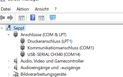

I went back to 1.8.19, but now the Mini Pro does also not work with this version any more.
Here is a screenshot of how Windows sees the CH340:
Screenshot (743)
It works. I uninstalled the IDE, deleted the content of the folder .../AppData/Local/Arduino15 and then reinstalled. This works.
Going back to IDE 1.8.19 I also have to delete the folder Arduino15 before I install the IDE. It also works there then.
Thank you for your help!
Karl
