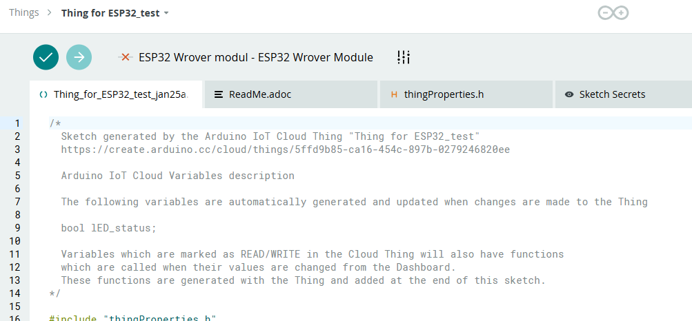

I am trying to add an ESP32 board to the Arduino Cloud for the first time. Everything works fine through the IDE (uploading the code) but when I try to upload the same code through the Cloud I get this error:
And furthermore, whenever I try to create a "Thing" in connection with this board, the ESP32 is permanently "offline":
Please advise where the problem could be..

Hi @matio81. Due to the combination of two bugs (espressif/arduino-esp32#8744, espressif/arduino-esp32#10271) in the 3rd party "esp32" boards platform, it is not possible to upload to the specific ESP32 board you are using via the serial port when using Arduino Cloud.
I recommend using Arduino IDE to develop sketches for this particular board. Those bugs have already been fixed in the platform, so you won't have any problem when using the recent versions of the platform with Arduino IDE, but the fixes have not yet propagated to Arduino Cloud and it might be some time before that happens.
Note that, although it will be most convenient to use the Arduino Cloud web interface for the initial setup of the Arduino Cloud Thing, after that you can use Arduino IDE for all further development and serial port uploading of the sketch. You will see newly created Thing sketches under the "Cloud Sketchbook" tab of the IDE's "SKETCHBOOK" panel after you click the "Sync" icon at the bottom right corner of the panel.
