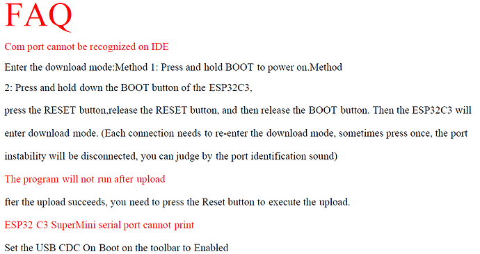

I was having the same issue until I pressed both Boot and Reset while plugging the USB cable. Then release the reset and finally Boot.
It's working fine again.

Try this
ESP32-C3 Super Mini - Can't upload any sketch - #21 by 6v6gt
post #23
