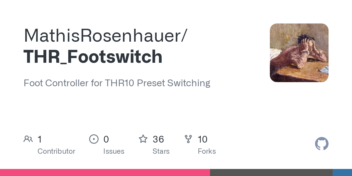

Similar projects on github for other guitar amps. One uses a USB host shield. The other uses a Teensy 3.6.

Interesting, however both of these use Midi... looking for USB communications between two devices. Thanks for the suggestion though, will have a peek at the code.
I do not understand your distinction between MIDI and USB. MIDI messages can be sent over Bluetooth, WiFi, Ethernet, and USB, as well as 5-pin DIN. HID messages can be sent over USB and Bluetooth.
If your amp/effects box uses HID over USB, then the USB host libraries (USB Host Shield Library and Teensy USBHost_t36) are capable of doing HID over USB. Take a look at the library examples.
