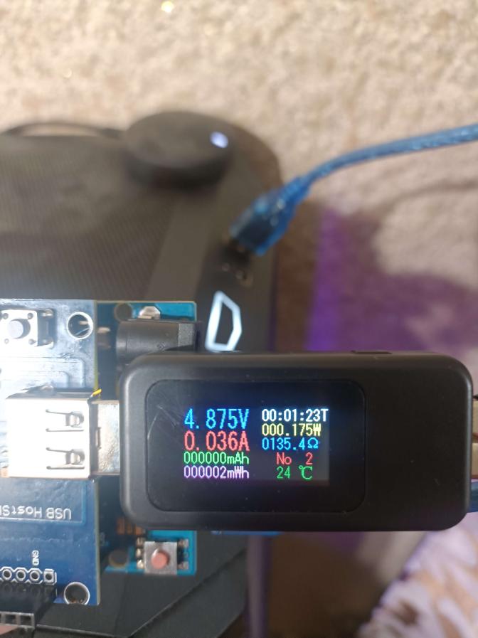

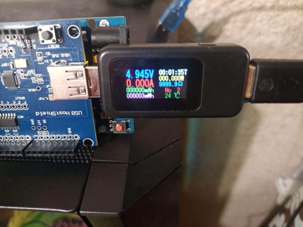

I have an Arduino Leonardo R3, I connected a USB Host Shield to it. I have connected my mouse to the USB Host Shield, but the USB Host Shield does not see my mouse. I know that initially the USB Host Shield has no power, that's why I soldered it as in this video USB HOST SHIELD No Power FIX - YouTube USB Host Shield began to give power (I checked via Voltmetr), but he still does not see the mouse

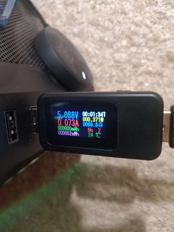

I have an option that there is not enough power (Volts), but I doubt it

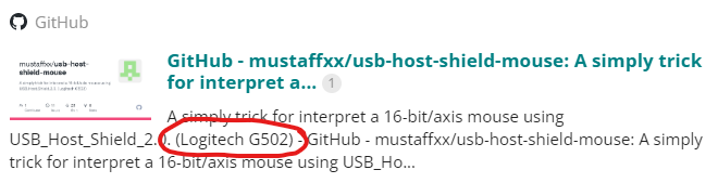

Are you sure your Logitech G305 is compatible with it?

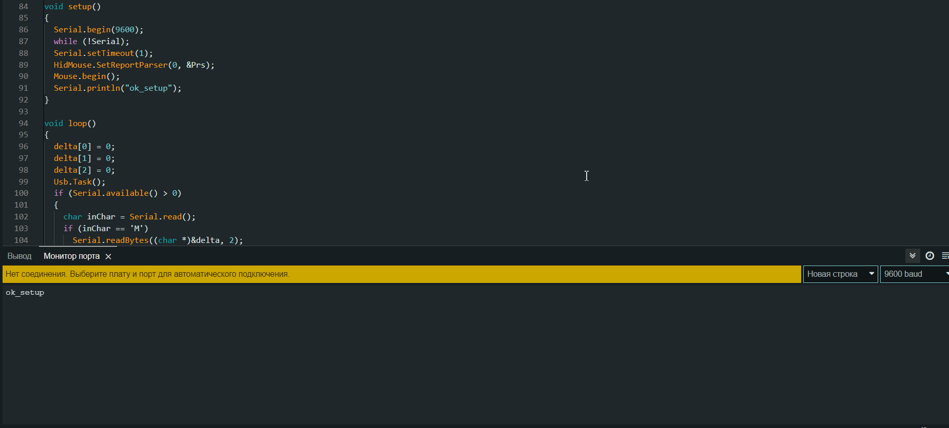

Try inserting some Serial.println("ok"); at some places in the code to see if your code reaches those points of the code.
The Setup function works all over. The loop function works all over, even moves the mouse (Mouse.move(delta[0], delta[1], delta[2]); I changed delta[0] to 1 and there was a movement of 1 pixel by X), but the Parse function does not work, so I cannot move the mouse when my mouse is in the USB Host Shield. I don't understand why USB Host Shield doesn't see my mouse.
"OSC did not start" means the Leonardo cannot communicate with the USB controller on the shield. Check for broken or bent pins. Make sure 3.3V is available on the shield. 3.3V powers the MAX3421E chip which is the USB controller. The board may be defective.
