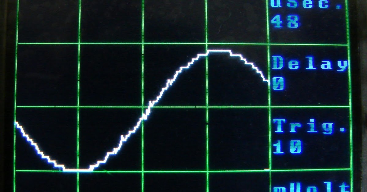

Read the data-sheet ! With 10 bits resolution ADC max sample rate is only 15ksample/s.
Due to Nyquist/Shannon theorem max frequency is 7.5 kHz.
BUT at 7kHz you have only ONE point per period.
Remember to be able to see a rectangular signal at "F" Hz your bandpass have to be 10 time more higher -> see "Fourier series"
I have an USB HANTEk 6082BE given for 80MHz bandpass.
Other Hantek model exist like DSO series with higher "announced bandpass" but I have doubts about announced performances.
HANTEk 6082BE give me total satisfaction with board working at 16 MHz like Arduino UNO and Mega.

Joke or no joke, this could be a project that is fun to build:
