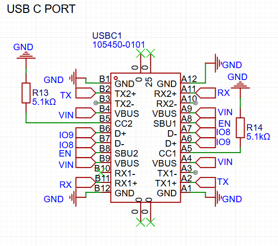

I created a custom ESP32 C3 board and I am using an external USB to UART board to program it.
I am using a USBC port to power the project, so decided to use the other pins to pass the enable pin (EN), and boot mode pins (IO8 and (IO9); however, I am having reliability issues. The connector has to be put in just the right spot with my mating device, and program uploads frequently fail. An image of my schematic is below.
Is there anything inherently wrong with what I am doing with this project or do I just have to shop around for more reliable USBC connectors. AKA: Is a usbc port designed to pass serial communications through it? I am not using the differential pins so I wonder if I just have a poor connection due to that.
Also, the power connection is very consistent and I have never had issues powering the project, but I do notice that the connector will eventually wear out and stop working with the programming board.

Then there is no point in having the resistors on the CC pins
want to know if this is a common use for a USB port
No it is not.
if I should be using differeicital signals or something to ensure I have a good enough connection.
There are no USB signals on that connector, so you can do whatever you like. Your problems may be somewhere else in your design.
If you want help, post you entire schematic.
Attached is the schematic:
ESP32 USBC Question.pdf (173.8 KB)

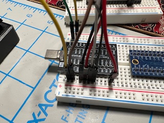

Here is a picture of the mating connector:
Let me know if what I am doing should be able to send serial communication and controlling pins high and low or if I should be doing it with other circuitry.

The male connector I had in the picture above connects to the schematic I made.
For a usb to uart board, I have a ESP32 dev board that I removed the ESP32 from and I am just using the chip on that board.

From what I can tell there is nothing I am doing completely wrong with using a USBC port as a a pass through instead of USB functionality, but I do believe I still need the R13 and R14 resistors to ensure that the power supply will deliver power.

While is sounds like a generally bad idea, I don't see any reason that it shouldn't work.
Your description of the problem sounds like it could be just a case of poor soldering (or a bad connector, as you say.)

Are you meant to be using D+ connected to IO9 as I think it should be IO19, and the same for D- not on IO8 but on IO18. Though you said it worked before so maybe your diagram is wrong.
Also, do you have ESD protection on the D+ and D- lines?

@stem_forge78 I connected the D+ and D- pins through io8 and io9 because I am not using them for USB purposes. They are just being used to access these pins on the board without needing an additional connector.
I am not using esd proctor currently on these lines which is something I should consider adding.

Something else that is interesting is the UBSC connection is working much more reliably now. I changed the female connector to a G-Switch GT-USB-7062 which is more expensive and presumably higher quality than the previous one I had on there. That was likely the source of my poor connection.
