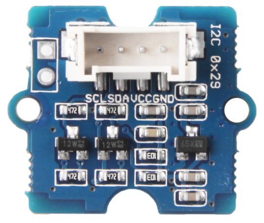

Hello, I use 2 sensors Time of Flight VL53L0X distance (in grove). My program allows to use the 2 at the same time with a kind of manual initialization to differentiate the 2 sensors. The problem is that every time I disconnect the card I have to do this again and it is contradictory to the purpose of my project (which is autonomy). I try a lot of stuff like plugging the sensor into a digital port and bring it back to the I2C but it does not work ... I do not know too much and I have more idea so if someone one to the solution ...
Please, post the image of your sensor and the codes that you have tried. Which Arduino are you using? UNO or NANO or MEGA or DUE?
i use arduino mega

my sensor Grove - Time of Flight Distance Sensor VL53L0X | Seeed Studio Wiki

The procedure for setting alternate I2C address is described here. It must be performed every time the device is powered up. You could automate the process by wiring each device’s XSHUT pin to a separate digital output. Then, in setup(), run the sequence in the above link by sequentially activating the XSHUT pins and calling the setAddress() or begin() method.
This is the picture of your sensor which shows that the I2C address is 0x29. If you want to connect more than one such sensor in your project, you have to use I2C Bus multiplexer.
gfvalvo:
thx for your help.
i can use the 2 sensors, this parts works, but i would like more information about automation.
GolamMostafa:
As I posted above, there is a procedure for changing the I2C address. No multiplexer required.
gfvalvo:
i would like have more help on this point. I don't use XSHUT, i use GROVE and i have already try but I can not do it... i need more information for use it pls.
I don't know what GROVE is. The procedure is detailed quite clearly at the site I linked. Have you read it?
yes i have read,
I had misunderstood sorry
