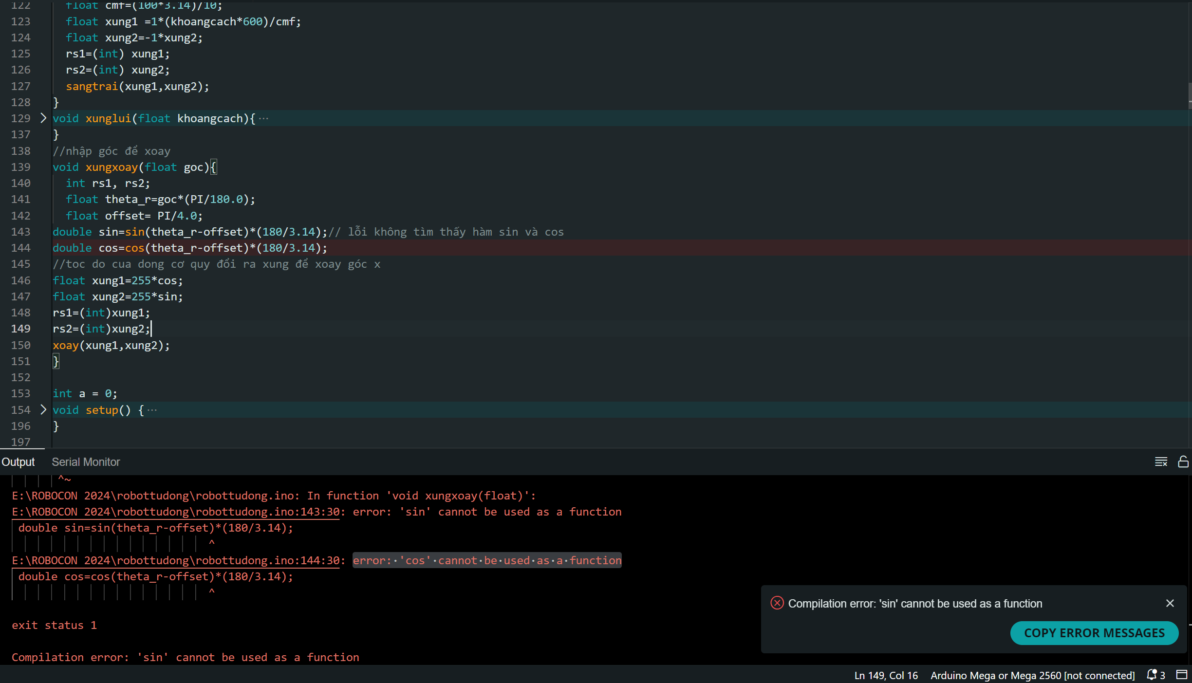

'''i can't call sin() and cos() in arduino i don't know how to use it
example in my code :
float theta_r=angle*(PI/180.0);
float offset= PI/4.0;
double sin=sin(theta_r-offset)X(180/3.14);
double cos=cos(theta_r-offset)X(180/3.14);
i want to try it but i receive it back "error: 'cos' cannot be used as a function"'''

The word "sin" and "cos" are reserved by the function names. You may not create variables with those names.
You probably need a '*' instead of a 'X' to multiply with (180/3.14).

void xungxoay(float goc){
int rs1, rs2;
float theta_r=goc*(PI/180.0);
double sin=sin(theta_r-offset)(180/3.14);// lỗi không tìm thấy hàm sin và cos
(180/3.14);
//toc do cua dong cơ quy đổi ra xung để xoay góc x
float xung1=255cos;
float xung2=255
sin;
rs1=(int)xung1;
rs2=(int)xung2;
xoay(xung1,xung2);

my problem is can't call sin() and cos(). i'm serach in internet my problems so i need #include <math.h> but i don't find math.h any where
The (180/3.14) conversion makes no sense. sin() and cos return a number between -1 and +1. A conversion like that would only make sense on the result of asin() and acos()
