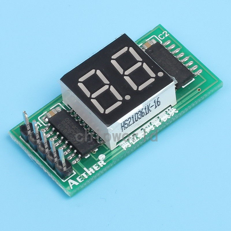

I bought a so called 2 Bit 2 Digit LED Display
(http://www.ebay.de/itm/74HC595-2Bit-2-Digit-LED-Nixie-Tube-Display-Module-3-3V-5V-Digital-Tube-/331921516802?hash=item4d48106902:g:GkcAAOSwtnpXipH4).
Unfortunately I didn't found any documentation of this device.
I'm looking for a sketch with or without additional library to display two digits.
Has anyone already used this display?

What a silly web page, in no way is this a Nixie Tube display. Can you say what numbers are on the two chips because that is a useless seller who doesn't know what he is selling.
The two chips are 74HC595 shift registers.
OK so my guess is that the shift registers simply connected to the seven segment displays. As a start I would use this tutorial to work out how the display is connected to the shift registers. The 74HC595 Shift Register | Arduino Lesson 4. Eight LEDs and a Shift Register | Adafruit Learning System

It is likely that one shift register is connected to one display.
It's a single 2 digit display, not 2 single digit displays. I suspect it probably has common anodes or cathodes and will need to be multiplexed.
Looks like its common anode. Poor design. No series resistors or transistors. Don't expect it to last for years.
I also think that multiplexing is necessary. I tried to find out the behaviour of the two shift registers. If I send 16 bits to the module and I send the same bit-pattern again, I get different results. Has anyone an idea about this behaviour?
I find that very hard to believe, can you post your code?

Very strange. Are you absolutely certain that video goes with that sketch? Could you have mixed up the data, clock or latch pins? Are you sure the chips are 74hc595? (That is what I would have expected, but I can't read the markings on the chips in the pics on the eBay page.)
P.S. please learn to post code and links correctly.
The first 74hc595 selects the digit, the second selects segments. This code did the job :
