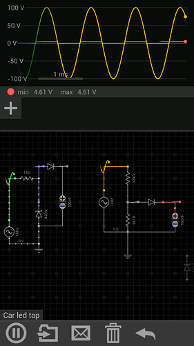

If you simply want to tap off the led current... all you need to is make sure arduino does not see > 5v
So a resistor divider will do it, no opto required, a 1k resistor and a 4v zener 5v may be on the boundry due to voltage spikes a 4v zener will ensure it does not go past 5v..
If you're really serious use a 5v TVS diode to clamp down the voltage from the resistor divider, slap in a cap to help give a nice dc 4-5v cleanish signal ..
I had to use ac input to simulate voltage spikes.. you'll notice how the resistor divider works providing you don't go over your expected voltage, while the zener diode will happy take 120+v and you need not worry
cjdelphi:
I prefer to use the Opt Isolator, since the voltages can sometimes jump very high, and I'd rather have a burn-out iso optocoupler than a burn out Arduino :wink:
But at the same time, I'd like to protect the iso optocoupler as much as I can.
