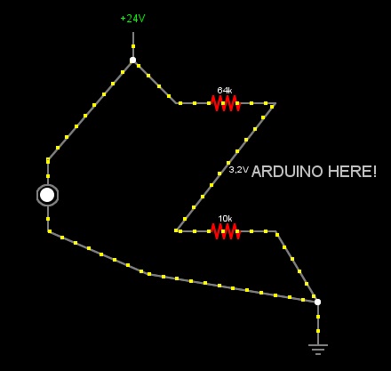

Here is my situation: I have a 24v/1A (that’s a lot of watt!!) that’s used for light a powerful LED.
What I want is to know with an arduino due what LED are ON and what are not.
Obviously I need something that drops the current from 24v to 3.3v, but I also must be sure that arduino do not get too many amps.

If the 24V supply has a common ground with the Arduino, then a voltage divider is all you need to sense whether the +24V supply is present or not. You could use 10K for the lower resistor and 68K for the upper resistor.
An alternative (which does not required the 24V supply to have a common ground with the Arduino) is to use an opto isolator. Connect the input of the opto isolator and a 10K series resistor across the 24V supply. Connect the output side between an Arduino digital input pin and ground. Enable the internal pullup resistor on that Arduino input. See http://cq.cx/pics/int-digin-opto.png for the general arrangement, except I am suggesting you make R2=10K and omit R1.

@dc42: thanks for your answer.
If I have a common ground (not sure if I could but I hope), isn’t it risky to use only a voltage divider?
I mean: I should have 24v @ 1A from the source.
For using a voltage divider… is the “schema” attached correct?
Thank you very much everyone!
PS: The resistors aren’t going to get really hot?
Yes, that arrangement is correct. If you use those value resistors, they won't get hot. But f you have the least bit of doubt about whether you can use a common ground, use an opto isolator instead - it's still only 2 components.

Any optocoupler with phototransistor output should suffice. You need a series resistor between the 24V and the input side of the optocoupler, to limit the current to below the maximum (which is typically about 20mA). But you don't need as much current as that, which is why I suggested using a 10K series resistor (giving about 2.3mA current). I'm assuming that you will place the optocouplers close to the Arduino, and use the internal pullup resistors.

Unless the 24V supply will be powered from the same mains outlet as your Arduino, then it is probably not a good idea to use a common ground, because by doing so you may create a ground loop and/or feed mains-borne transients into the Arduino ground.
opto is the way to go,
resistor divider, one of the resistors to the ground lifts, goes open circuit, , and you put 24 volts on to the arduino,
pop.
optos' the 24 volts is separated always from the arduino,

But Optos have a "line-in" with low-voltage. If I understand correctly, the EL817 has 1.4V, so I should drop the tension with a resistor...?
Then how I can choose the output at 3,3V?

Yes, I've already told you to use a 10K series resistor (twice).

No, provided the resistor values are high enough, the upper resistor will limit the input current to a value that the input protection diode can safely handle. But I agree that opto is the way to go in this case.
