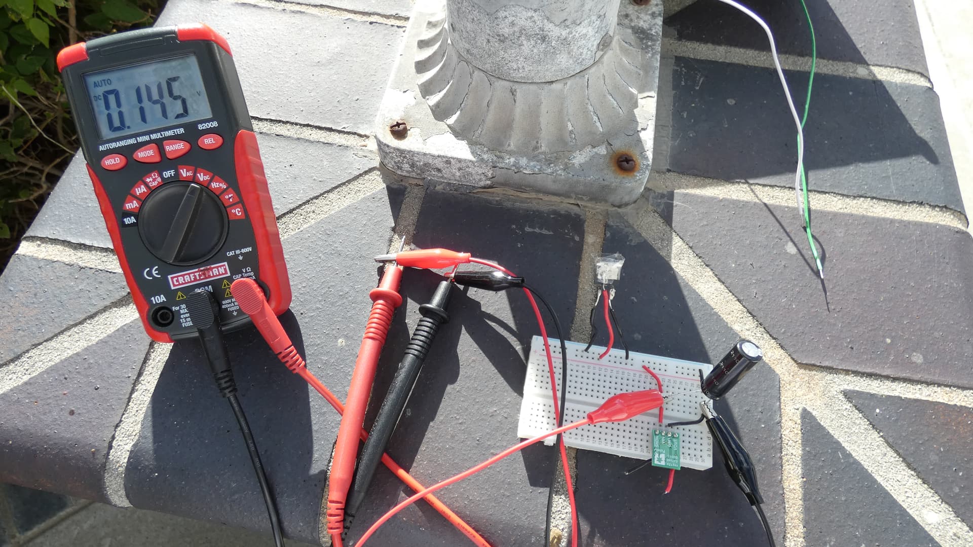

I still think you need to use a 4volt solar panel for a 2.7volt supercap.
And a shunt regulator that can take the current of the panel.
That can be as simple as soldering this board on top of your supercap.
Leo..

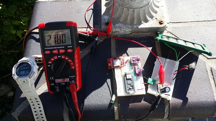

Meanwhile I tested out the 0.5v, 100 mA panels in series and this time got ~2.8 volts on a bright sunny day (~2.8V, 100 mA?).
It took about 7.5 minutes to charge from 0.4 volts to 2.8 volts for a 3V, 10F supercapacitor.

I gave you the option in post#64.
That board has a low idle current SMD 431 and a 2-transistor amplifier for up to 1Amp (maybe Chinese amps) solar current. The board will probably drain less than 40uA@2.7volt (the cap itself leaks waaay more), and it fits directly onto your 450F cap (or your 10F cap).
Leo..

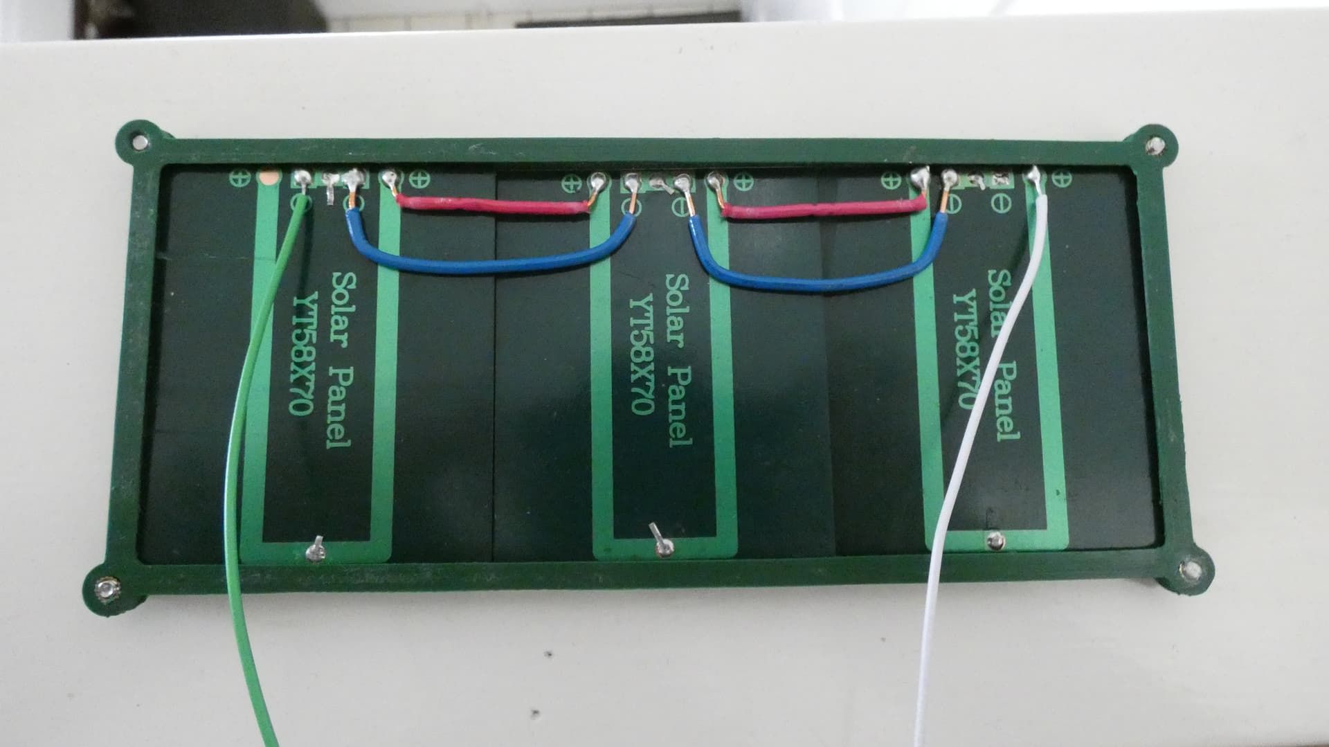

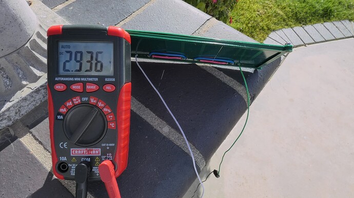

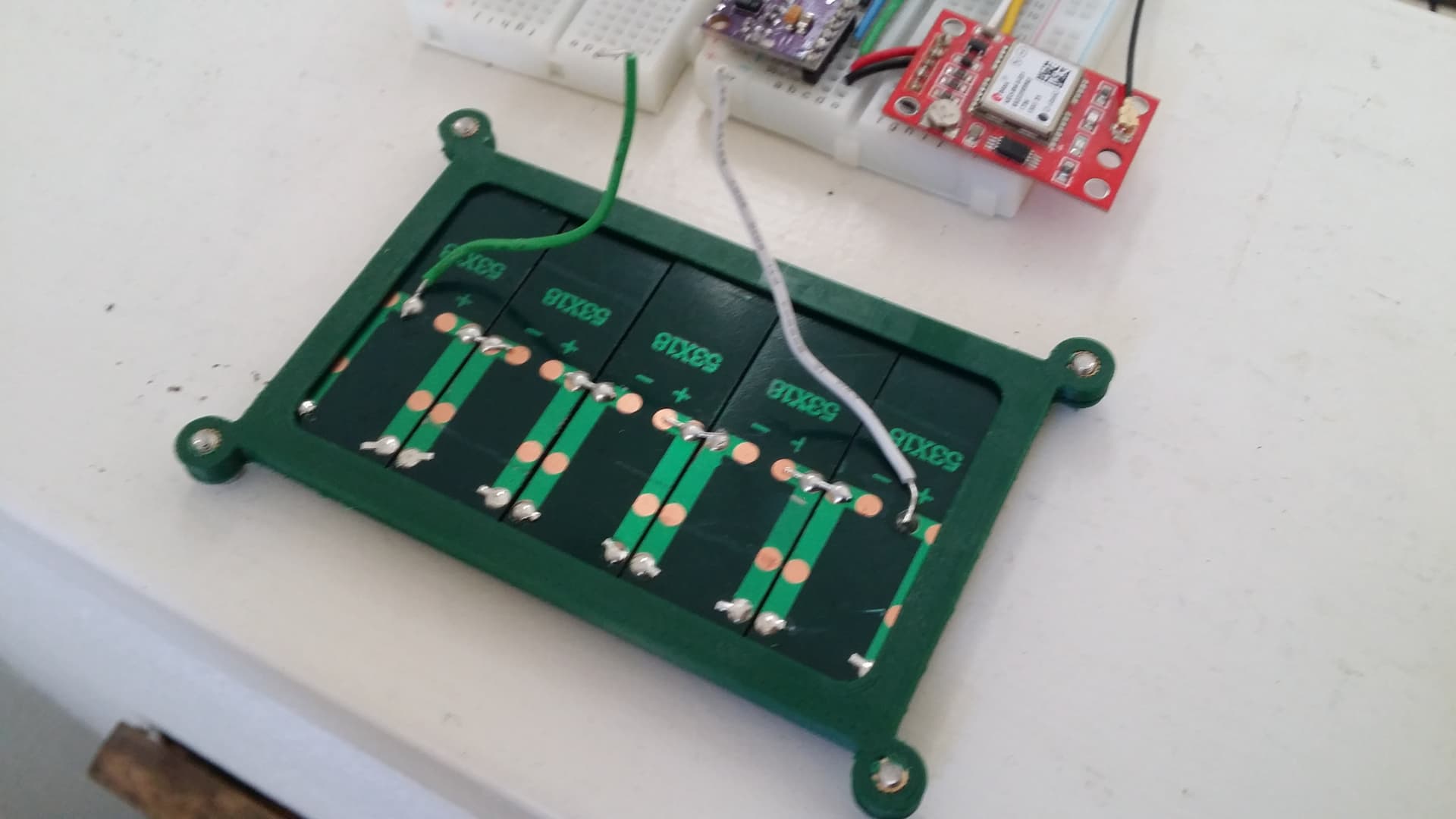

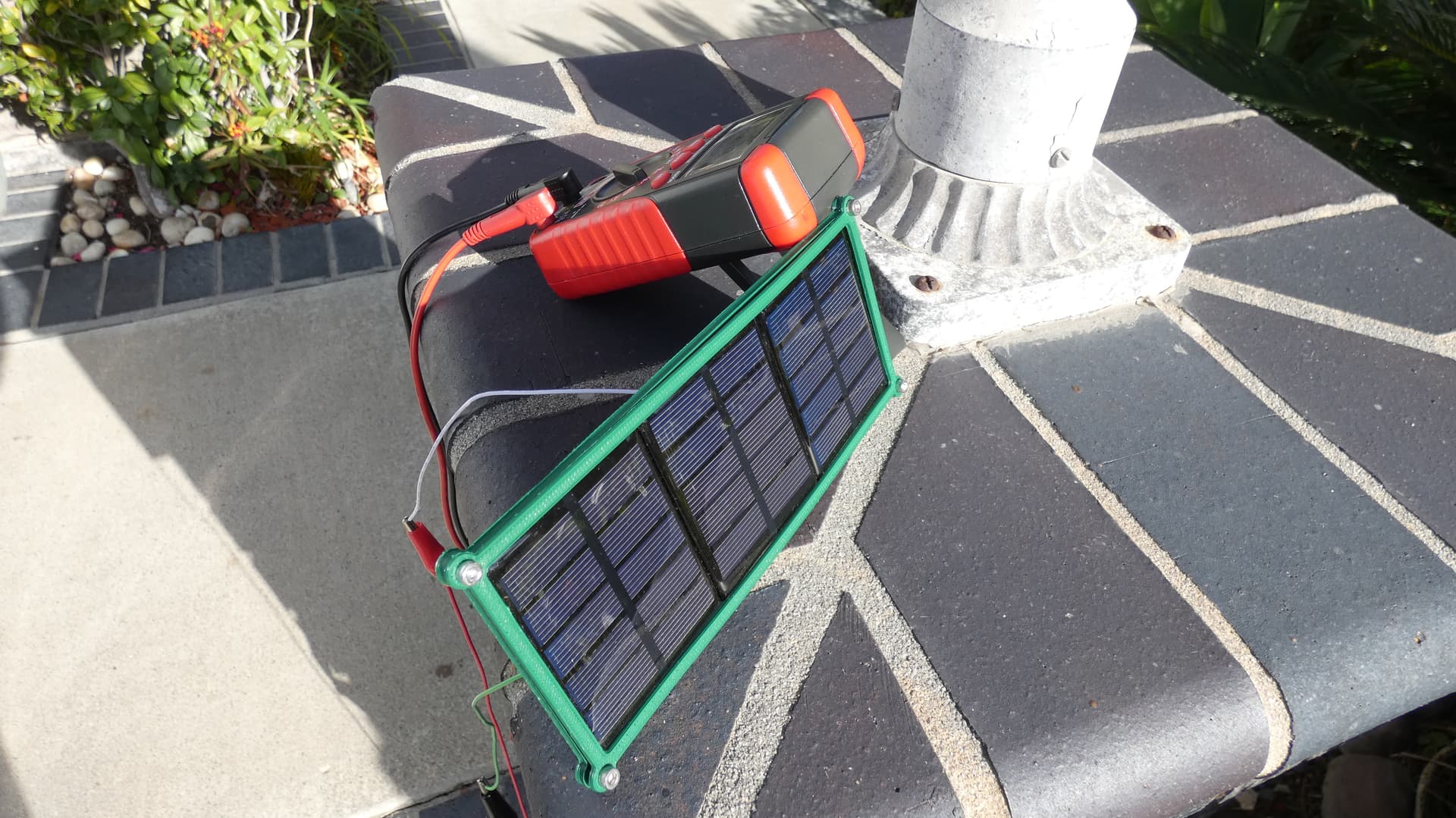

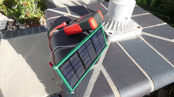

I managed to find these and they are difficult to find elsewhere.
They are 2.5V, 200 mA solar panels. With a Voc ~3.03-3.06 volts.
I soldered and wired them in parallel, so in theory they should be getting ~3Voc and 600mA.
Link below has 3d models in case anyone wants to 3d print the case that is holding them and links to panels and supercapacitor.
2.5V, 600 mA Solar Panel Soldering Fixture and Case

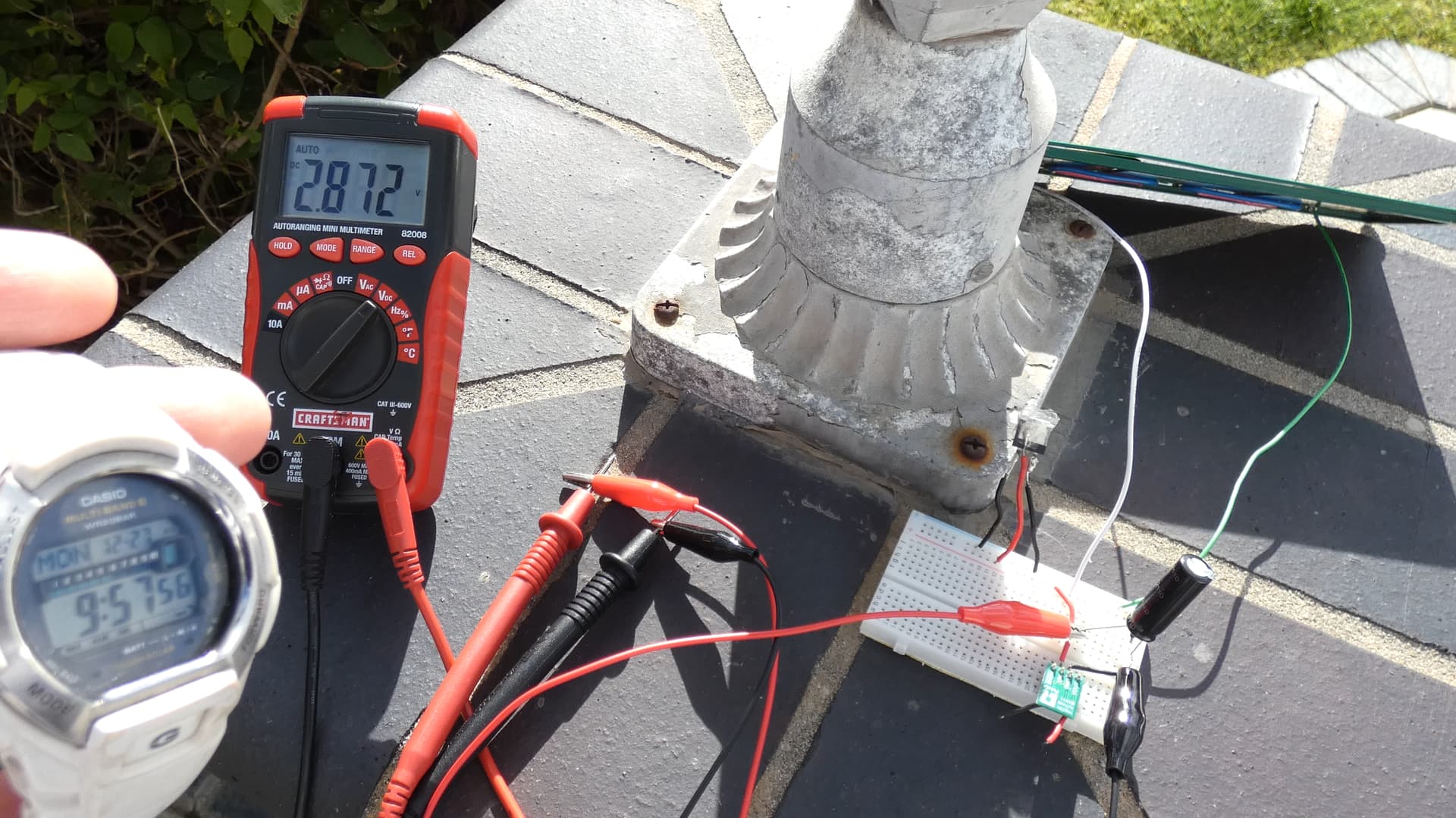

The 3V, 10F supercapacitor went from 0.14V to 2.82V charge in about 2 minutes in full sunlight.
I noticed a slight drop in previous Voc maybe due to solder or wiring? Good thing is it doesn't exceed 3V.
I noticed a slight drop in voltage as a cloud passed by and it was a good example of voltage drop from 2.8 volts to ~2.6 volts.
