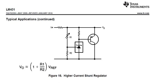

I currently use this shunt regulator circuit to charge a 18500 (1Ah) LiFePo4 battery.
The LM431, with it's 0.4mA idle current, is on the solar panel side of the backflow protection diode.
And the reference voltage divider that measures/sets max battery voltage is on the battery side, so battery drain after dark is only about 10uA.
Dark day efficiency can be improved by using an SMD type 431 voltage reference (NCP431).
They usually have a much lower idle current (~40uA) than the LM431 (400uA). And the reference current is also lower than the LM431 (2uA), so the voltage divider can be made with higher value resistor. Downside is that you then must add a PNP transistor to absorb solar panel current.

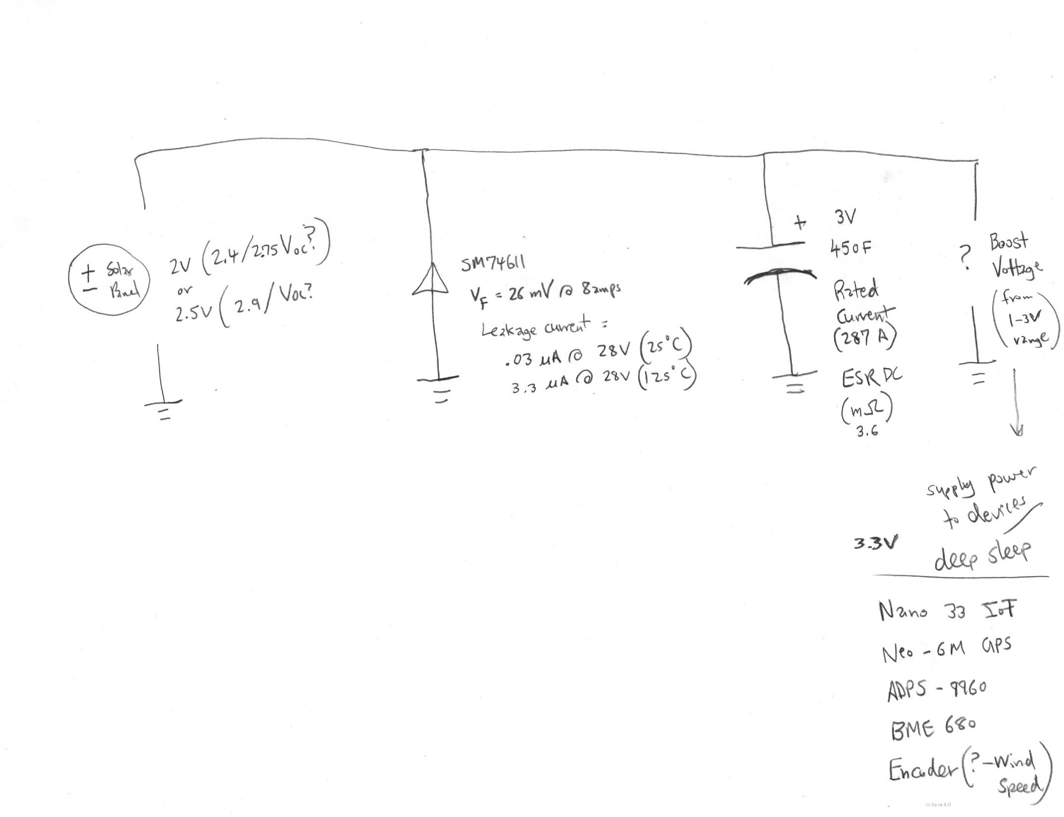

Here is the best schematic I could come up with. Hopefully I didn't make any mistakes.
No, use a 4volt/150mA panel for a single 450F supercap, and a (2.7volt) shunt regulator.
Can use the LM431 diagram I posted. Replace the 120k for a 100k, and don't use the 330k.
Charge time with that setup will be several hours though.
Did you see the 72H leakage of 1mA in the datasheet?
A supercap will leak a lot more than that in the first hours of being charged.
What is your reasoning to use an expensive/problematic supercap over a cheap/easy LiFePo4 battery.
The blocking diode in your diagram must go between solar+ and supercap+
not from + to ground.
Leo..

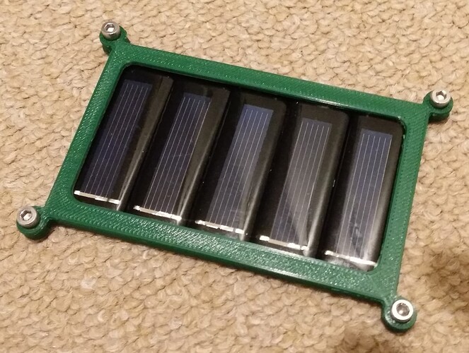

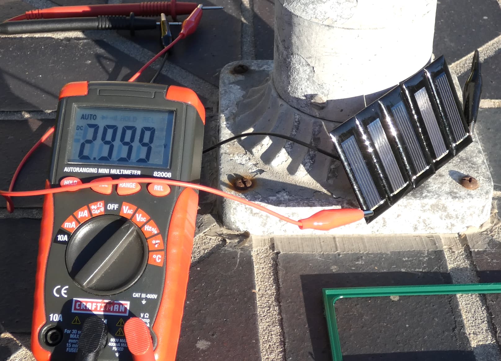

I built the 0.5V,100 mA (~0.6Voc peak) set of 5 solar panels in series (~2.999 Voc peak then drops slightly to ~2.98V), it's rated at 100 mA which is less than the current consumption of the Nano IoT and 3 peripheral devices currently (I haven't optimized power usage yet). My next goal is to get the 250 mA version of these solar panels.
The CAD model can be downloaded here in case any one wants to 3d print the case or modify it:
With this solution I wouldn't have to use a shunt regulator and resistors (although I'm not ruling them out, the current limitation is what I'm concerned about if I ever expand the initial setup I have with more sensors,etc..).
