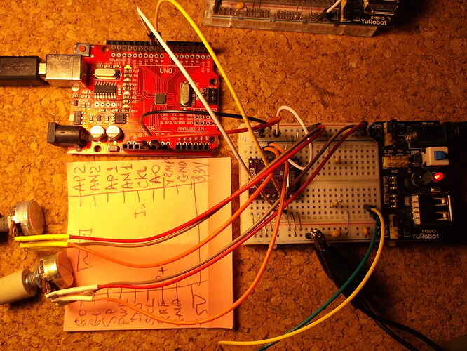

Using an ADS1232 with an Arduino UNO
(I'm new to external ADC's and SPI in general, so please be patient)
I need an external ADC for a school project as the resolution of the internal ADC of the Arduino UNO/Nano/Mega is just too low. So I decided to buy one on Amazon which was already soldered (See attached picture). It arrived yesterday and I realized that I have no clue how to use it. After some googleing I found these posts:
http://forum.arduino.cc/index.php?topic=130277.0
http://forum.arduino.cc/index.php/topic,128823.0.html
I connected (based on the code I found) the following pins to my Arduino Uno:
Gain0/1 5V
REFP 5V
SPEED 5V
TEMP GND
A0 GND
CLKIN GND
DOUT D12
CLK D13
PDWN D9
The code:

(based on: https://e2e.ti.com/support/data-converters/f/73/t/560004?Help-with-setting-up-an-ADS1234-with-4-load-cells-to-an-Arduino-Uno-or-a-Raspberry-Pi-3)
As said in the Datasheet, I can connect the AINN1 pin to ground to measure an unipolar signal on AINP1.
I'm not quite sure what a differential Signal is, so this was the best I can do.
I thought, if I connect AINN1 and AINP1 to Grund (or AINN1 - Gnd & AINP - 5V), I should get a constant number as result.
But thats not the case. I get random numbers starting at around -825242
and ending at ~1713729126.
Somebody knows why?

Looking at the picture, I see only 5 wires connected. Please post a new photo with all wiring, in initial message there is only 9 pins indicated. What about +5 and +3, where it's connected?
Edited.
I tested your code, till new pics aren't ready yet. Also get like random data (SPI code from OP). Investigating an error, I came to conclusion that using SPI with this adc was a bad idea. It may work if "DATA Ready" feature is not effective, but in your case:

ads1232_uno_1d.zip (1.87 KB)
That is not a good solder job. None of the pins on the left side look good. The bottom three pins on the right also look dubious, especially the GND. Those poor connections could be the problem.
Another problem is the jumper wires you are using. Looking at the jumper connected to SCLK, you can see that the metal pin is only about half the width of the breadboard hole. If you push on the wires I'm sure you'll find that the jumpers wiggle around which is also a poor connection.
You need to have the headers soldered to the board properly and use better jumper wires.
Pete
And again I want to say thanks to all replies and the constructive feedback I got. But it looks like I expressed myself wrong. I wanted a chip that is already soldered onto a PCB Board.
el_supremo:
Pete
The headers are soldered by me, so thanks for that...
But anyway I decided to resolder them as good as I can. In addition to that I rewired everything and checked the connections from header to header. Instead of using an UNO I now use a Nano, but thats not changing much. A photo of the result is attached.

  3. I soldered crystal by myself, and your board is up side down, it's a good habit to show an IC to the user.
  4. If nano is 5V, than you should power up adc module from +5V, dispute it says +3V. See on my photo, both sides analog & interface powered from +5V lines. There is a reason, why TI divides analog power and logic power to separate pins, is to have ability to interface a module with 3.3 or 5V mCPU. Marking mistake is to module makers,
I just connected the 3.3V pin to 5V and it worked... partially. I now get something (using "d"), but only "read-back: 32767" and it isn't changing. Typing in "k" to recalibrate it gives

Your photo shows GAIN0 &1 connected to +5, could you try to Gnd?
That doesn't change anything, as I just tested out
I'm afraid, the module is damaged by applying +5V to SCL pin same time as interface logic power was +3V.
Try to remove power for a few minutes, see if it's make any difference.
