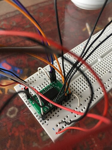

I'm new to Arduino and considering this I'm working on quite an ambitious project. I would like to turn a harp sculpture into an instrument with capacitive touch sensors.
I found a code by Esperienze Elettroniche for Arduino UNO with which you can turn any metal object into a capacitive sensor with just one analog pin. It works perfectly fine! As you need A0 as a pull-up resistor there's 5 pins left to turn into sensors. I would like to have more touch sensors though, so I built a 16-channel Multiplexor similar to the CD74HC4067.
I found out how to connect the MUX to the Arduino by connecting S0-S4 to digital pins 8-11, GND to GND, VCC to 5V and SIG to A1 and an according code. I don't know how to combine those two codes though in order to let the touch sensor code run through the MUX so to say..
Here's Esperienze Elettroniche's touch sensor code combined with a code I found on hooking up a MUX with Arduino. It gives me many errors :wink: I thought I could assign A1 to all of the touch sensors as this is where the MUX's SIG connects with the Arduino, does that make sense or does that confuse the program?

Attached you'll also find a picture of MUX setup. I put 5 black wires for sensors in I1, I2, I3, I4 and I5 (pins 4-8 on the MUX). Thanks a lot for any hint!
Best wishes, Elena

I think if you use 2 x 16 multiplexers with 2 analog inputs it would work fine. So you will have 32 capacitive sensors.
Hi, @flashko
If you are going to multiplex the capacitive pickups, I doubt if you will have much success.
The added capacitance of the multiplexers and the length of the wiring will effect your results.
Also the function of the Arduino involves pulses being sent out the capacitor sense line and a response time being observed, not as simple as multiplexing switches.

PS. If you are going to try, can I suggest you try 16 channels first with basic code to see if it will work?
thanks for this advice. For now I combined three digital cap sensors with the 5 analog ones mentioned above, so 8 sensors in total. This worked pretty well (with some shaky, unforeseeable results in between, like numbers going down instead of up when touching -> I just added two thresholds so in any case of touch my sound would be triggered). I also have the feeling that adding a MUX complicates capacitive sensing. I will look into the different options and keep you updated.
