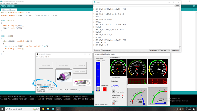

@GolamMostafa I have made some progress. Here are the results.
I connect the Tx pin of the MiniBoard to the Level converter as shown in your post. Which is connected to the Rx pin of the arduino uno (pin 11 in my case)
Using this I am able to read the data. It looks like this:
I made a small change to the code to read the data in the format that the manual specifies. (See examples at the end).
This is working fine it seems.
But the problem arises when I connect the Rx pin of the Mini Board as well. That is connected to the Tx pin of the arduino uno (pin 10).
As soon as I connect that I get the following message:
Why would this be happening? What can I do to correct this?

Its still not working though. (Only partially working. I am only able to receive data).
Please refer post#50 for the problem.
As I said you --
Disconnect the PC from the Mini Board and keep only the PC, Arduino, ECU, and Mini Board. Now try to send command to the ECU via Mini Board and Arduino.
TX-line of Mini Board/ECU can drive two devices simultaneously.
It is with the RX-line of the Mini Board, which cannot be connected with TX-line of two devices as by default (when there is no transmission) the TX-line remains at HIGH state. As a result, command sent by either of the two devices can't be accepted by the Mini Board. This is my analysis.

@GolamMostafa From post #23. The ECU is not detected when the Rx line of the MiniBoard is connected to the Tx of the arduino uno. The PC is connected to the arduino. The arduino is connected to the Mini Board and the MiniBoard is then connected to the ECU. So I am trying to get the data from the ECU to the MiniBoard to the Arduino which can then give that to the PC.

@GolamMostafa Yes, but I tried with the PC connected to the ECU. When the PC was connected I was able to connect the Rx pin of the Arduino to the MiniBoard's Tx pin and was able to read the data. There was a continuous stream of replies of the form
1,HS,OK,3500,568,1.32,11,30.1
When I started up the software on the PC. This is shown in post #49.
But when I also connected the Tx pin (talking only about software serial ports) of the arduino to the Rx of the MiniBoard then I got the message "ECU not connected" as in post #50.
Therefore, I was never able to "send" a command from the serial port, was only able to read.
