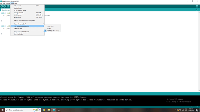

@GolamMostafa Here are the results.
Before connecting ECU to PC.
After connecting ECU to PC
I sent the command for:
  1. No line ending
  2. Newline
  3. Carriage return
    No reply on Serial Monitor

I don't see the SM. What you have shown is the IDE. Data coming from ECU will appear on the OutputBox of SM (Fig-1. post #63).
Yes, I tried that, no reply on serial monitor.
(As I say in my previous post at the end)
Also, in the previous post the 2 images correspond to when the ECU USB cable is not connected and connected respectively. A new tab called COM5 appears but doesn't have a particular name.
Please, go to the Device Manager and check that the device (ECU) is there with the driver installed. I believe that the IDE will be able to communicate with the ECU when the Engine Software can.
