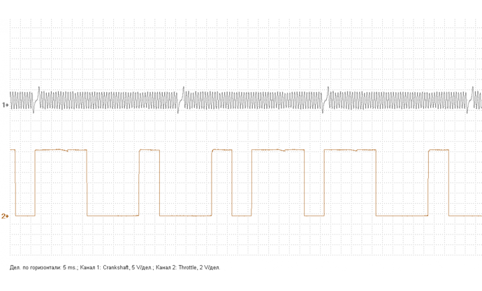

New member and super new to arduinos. Ive had some success with using others sketches and loading the code to some arduino nanos. For this project id like to use the crank sensor (60-2) trigger wheel to and an arduino to simulate the cam sensor output to the ecu. The engine i have is a early vw engine that uses a single window cam sensor and id like to take advantage of a later model ecu that utilises factory lambda control and sequential ignition (coil on plug) vs the old distributor. Currently i have used a oscilloscope to read the cam and crank signals from the engine that runs the ecu id like to use for a start. To be clear im not asking for handouts just some pointers or any good reading material to start on that may help me reach my goal. Thanks to everyone on this great forum and its really a miracle what you can do with these little dev boards!

My maths and physics teachers would have had my guts for garters if I posted a graph just like that!!! :o
What are the axes and what are the two traces?
