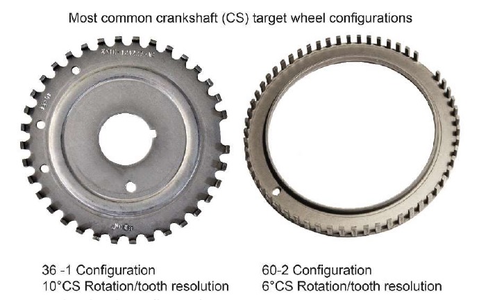

A 60 - 2 configuration means that there is a tone ring on the crankshaft that has spacing for 60 teeth, but only 58 are present. The two missing teeth identify the #1 cylinder at TDC. If it was 36 + 1, it would be 36 teeth on a 360 degree wheel, with #36 having an extra tooth.

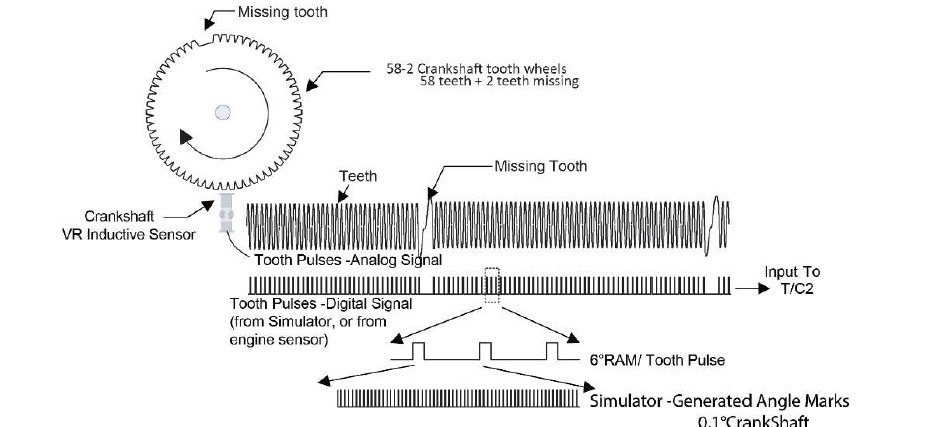

I would start by drawing a timing graph of the signals that you would need to be produced.
This would be basic logic counting and a conditional output function.
I got these pics from this article, it does go into hardware but lists the ECU type input signals that would be encountered.
https://iopscience.iop.org/article/10.1088/1757-899X/252/1/012099/pdf

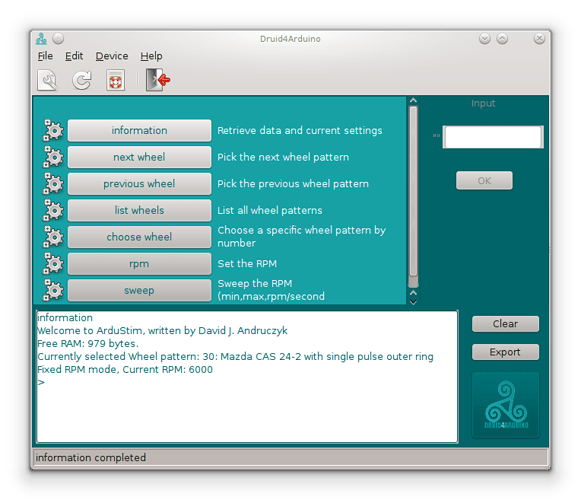

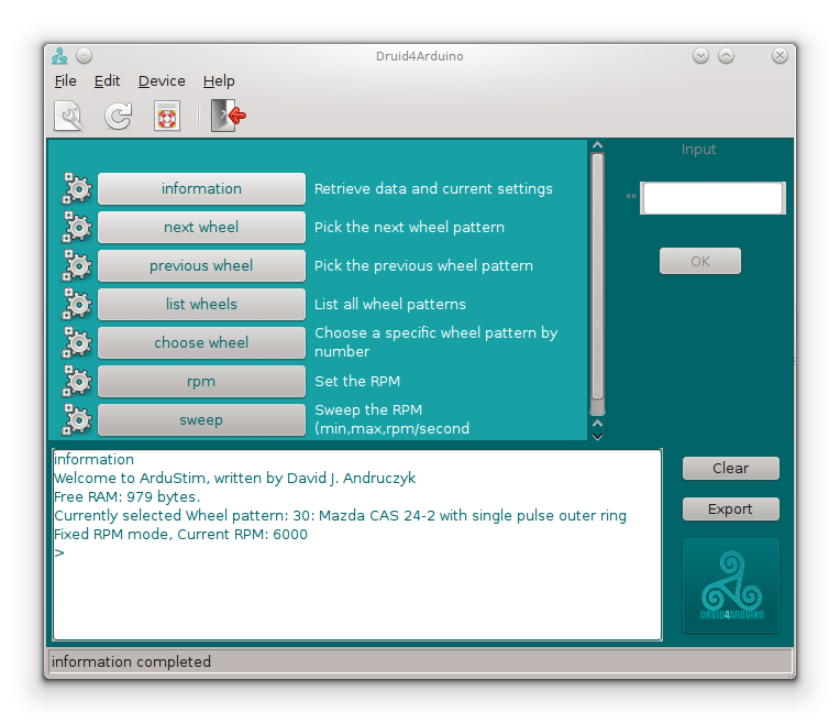

Take a look at Ardustim.
That is exactly what I am looking for but how do I build it? Or can I build it with the UNO? Like I said, no experience programming or with UNO. Need laymans terms guidance. Electronic part not a problem.
