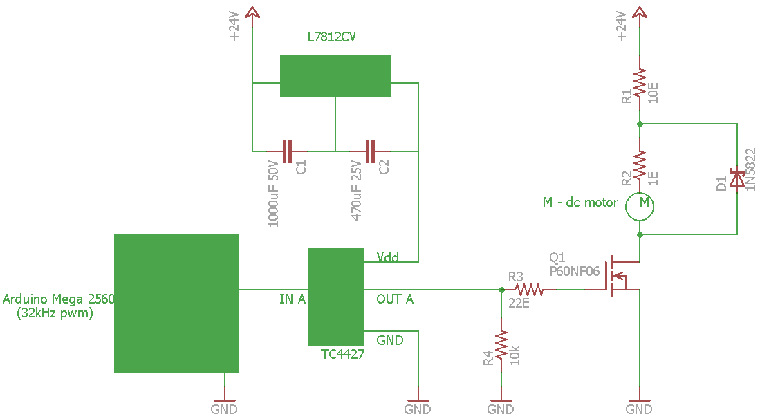

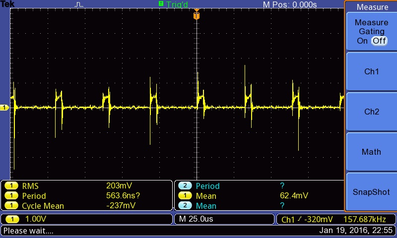

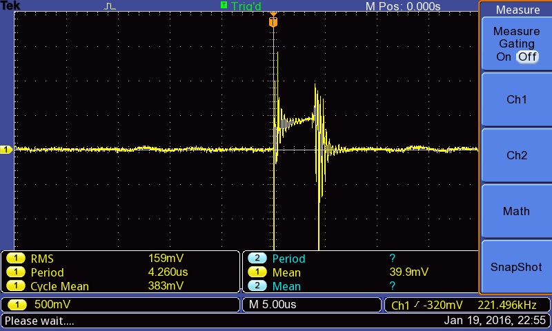

im using DCX22L EB KL 24V - Maxon dc motor. There is a need for stalling the dc motor in my application. I'm a mechanical engg student, with limited electronics knowledge. i tried a circuit(attached below) using mosfet n arduino to control the motor torque by varying the duty cycle of PWM(30KHz). The voltage variation across the dc motor is measured using oscilloscope across a shunt resistor as shown in fig. and oscilloscope image is also attached.
Is there any problem with the circuit because its showing lot of fluctuation ?
Please give suggestion to remove this fluctuation
thanks in advance
Fail1: You have probably fried your Arduino's output pin if that resistor to ground really is 10 ohms.
Fail2: You are not using a logic-level MOSFET.
Fail3: You are trying to do fast PWM without a gate driver chip.
With fast PWM (you say 30kHz) you must use a proper MOSFET gate driver, you cannot
get away with driving it direct from the Arduino. There are 1000's of low-side gate driver
chips to choose from alas, I've used the MIC4420 and MIC4422 before, they can drive
huge MOSFETs and are overkill. Read the datasheet.
That motor has 7.25 ohm windings and a continuous power limit of 20W (with heatsinking),
so you have to be aware of that if running at the stall point. At 24V full drive it pulls 24*24/7.25 = 80W,
so you can't stall it at full drive for long or it will be destroyed.
If you want to drive the MOSFET direct from the Arduino you will need:
150 ohms between Arduino pin and gate (so you don't over-current the pin),
10k from gate to source (to switch it off during reset).
You must stick to a few kHz max for PWM or you'll simply cook the MOSFET
with this low current gate drive.
You need a logic level MOSFET.
Oh, the other thing, no decoupling on the 24V rail? 220uF 33V or better would be a start, kill off
most of the ringing.
Its also recommended to add a small amount of ceramic capacitance direct across the motor windings to
reduce spark-noise (1 to 10nF or so) - that's not going to change the behaviour, just be kind to nearby
radios.

Looking at the pictures, the scope is connected to read current and is simply showing a lot of ringing when the current is turned off or on. I would experiment with an RC snubber across the motor. This is simply a series resistor and capacitor, say 100 ohms and a few microfarads. This requires trial and error and the idea is to change the ringing into heat.

thanku guys for valuable information, i modified the circuit as the attached one,
previously i try to us oscilloscope across the resistor outside the motor loop,(see previous post)
In new circuit i put oscilloscope on the resistor series to motor in the loop( resistor, motor, flywheel diode), it shows continuous current waveform as expected.
But the current Issue, when i burn the code in arduino, motor speed suddenly increase and then decrease to slower speed corresponding duty-cycle (even for very low duty-cyle "analogwrite(pin,1) ")
How to solve this issue, i want to run motor at corresponding duty-cycle without sudden increase in speed at burning the code.
