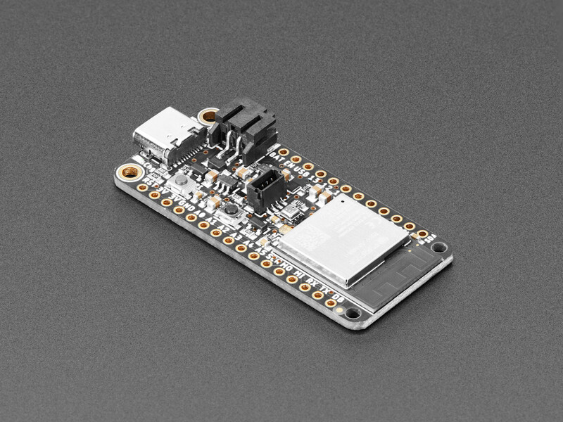

I'm using a Feather S2 controller in my project. It is battery powered, I do have a switch to turn the battery on and off, it's a push on, push off switch, at times I wasn't sure if the battery was on. I'm using the Arduino IDE for my project.
How can I turn the on board RGB LED on to indicate the power is on? Would just need to be one color and energized in the setup function.

Pinouts | Adafruit ESP32-S2 Feather | Adafruit Learning System says 13 is the red LED and 33 is the NeoPixel:
There are two LEDs you can control in code.
  • NeoPixel LED - This addressable RGB NeoPixel LED, labeled Neo on the board, works both as a status LED (in CircuitPython and the bootloader), and can be controlled with code. It is available in CircuitPython as board.NEOPIXEL, and in Arduino as PIN_NEOPIXEL.
  • There is a NeoPixel power pin that needs to be pulled high for the NeoPixel to work. This is done automatically by CircuitPython and Arduino. It is available in CircuitPython and Arduino as NEOPIXEL_POWER.
If you run into NeoPixel power issues on Arduino, ensure you are using the latest Espressif board support package. If you are still having issues, you may need to manually pull the pin high in your code.
  • Red LED - This little red LED, labeled #13 on the board, is on or blinks during certain operations (such as pulsing when in the bootloader), and is controllable in code. It is available in CircuitPython as board.LED, and in Arduino as LED_BUILTIN or 13.
I tried loading the the Blink sketch prior to posting my question, but got the error that LED_BUILTIN wasn't defined. After your comments a defined a LED as pin 13 and changed the references to LED_BUILTIN to LED, it now complied and loaded but the LED doesn't blink.
I then installed the NeoPixel library and looked at the examples but those are for external RGB strips connected to a pin. I added the NeoPixel library to the modified blink with the LED defined as pin 13 and 33, still no blink.

This Compiles --
// NeoPixel Ring simple sketch (c) 2013 Shae Erisson
// Released under the GPLv3 license to match the rest of the
// Adafruit NeoPixel library
#ifdef __AVR__
 #include <avr/power.h> // Required for 16 MHz Adafruit Trinket
#endif
// Which pin on the Arduino is connected to the NeoPixels?
//#define PIN        6 // On Trinket or Gemma, suggest changing this to 1
// How many NeoPixels are attached to the Arduino?
#define NUMPIXELS 1 // Popular NeoPixel ring size
// When setting up the NeoPixel library, we tell it how many pixels,
// and which pin to use to send signals. Note that for older NeoPixel
// strips you might need to change the third parameter -- see the
// strandtest example for more information on possible values.
Adafruit_NeoPixel pixels(NUMPIXELS, PIN_NEOPIXEL, NEO_GRB + NEO_KHZ800);

I don't know what's meant by There is a NeoPixel power pin that needs to be pulled high... [b]This is done automatically[b]... available as NEOPIXEL_POWER.
If it's automagic, what's availability for? Does it have to be asserted HIGH?
IDK -- I don't have one of these.
For low power/battery life, there's a power bus that can be turned on or off, and the Neopixel is attached to it. I think it's supposed to be toggled on automatically, require intervention to disable it, but the note you highlighted in #8 might mean it could need explicit control.
I'm surprised LED_BUILTIN wasn't defined as 13. (#4) Maybe PIN_NEOPIXEL and NEOPIXEL_POWER aren't defined either. Is it a genuine board with the same pins & board configuration, etc?
I did see earlier today that one of the LDO's needs to be set high as the RGB led gets it's power from that LDO, I'll see if I can find where I saw that and I'll try this sketch later.
As far as the blink sketch I sent you, I would have thought just defining the pin would do it. It does complie and I added a couple of serial.print statements, the code is running it just doesn't blink the led. I changed the pin to 33 and added the neopixel library that complied but also didn't work
Here's where I saw the reference to the LDO, it's on the datasheet you sent.
" I'm trying to control the RGB LED but it wont light up
The RGB LED (APA102) is powered by the second LDO. You need to enable the second LDO power via GPIO21 to be able to use the RGB LED. It's controlled this way to have the RGB LED power automatically shutdown when the ESP32-S2 MCU goes into deep sleep."
You're saying the sketch that I posted, as posted, didn't run a color change pattern (dead in the water)?
Are you using an Adafruit Feather S2 or a Unexpected Maker Feather S2? And are you using the Arduino IDE board library for the right board (Adafruit or UM?) They use different pixel power pins.
@DaveX it is an Adafruit Feather S2
@anon85221860 I haven't tried your sketch yet.
An interesting development but first, @anon85221860 your sketch didn't compile, for me any way, I get the error "PIN_NEOPIXEL was not declared in this scope.
I had previously downloaded the modified blink code. When I plugged the USB cable back in, to download your code, the blue LED is blinking. To make sure that was the code in there I downloaded it again, this time removing the NEOPixal library, that was in there previous. After it downloaded it was not blinking. I then unplugged the USB and plugged it back in and not it blinks. Is it not getting a reboot after download or something?
