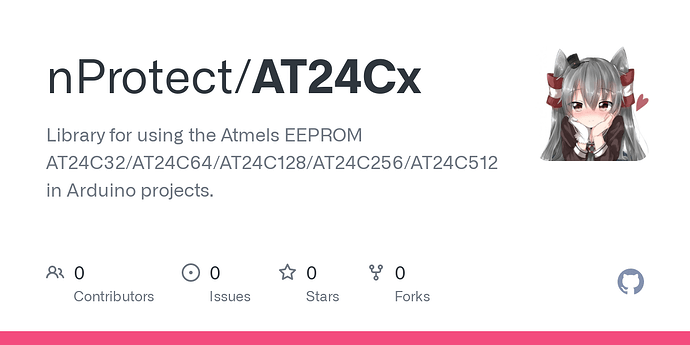

Did it work? I have the exact same issue with the Atlas Scientific pH sensor, and I purchased an external EEPROM module, but I still can't make it work. Could you share your code or any advice? Thanks.
If using AT24C, try this code on my github. Fixed compatible for GIGA R1
I have not had a chance to touch it unfortunately, parts are collecting dust. Hopefully I will get back at it over the next week or two. I will try @nProtect solution as well to see if that may be a better route. If you happen to try, please post your results.
