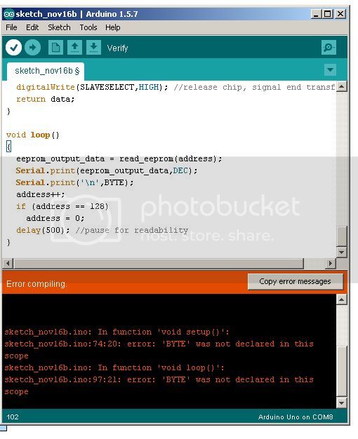

Thanks for the link, when I copy and paste the code from the tutorial and try to compile it I get the following error
Change each occurrence of
Serial.print('\n',BYTE);
to
Serial.println("");
Pete
Awesome thanks Pete, I was able to get it to work after altering the code as you specified. So with this I have proven to myself that I can interface with the external EEPROM through the copy and paste of a program. The project needs to be able to accept a small config file loaded by the user, and I believe this would require storage which is separate from the Atmega328P to prevent any alterations to the data stored on the internal EEPROM after the device is calibrated, Thus why I am trying to setup this external EEPROM. Before going any further is this the correct method or is there a much simpler way that I am un aware of?
