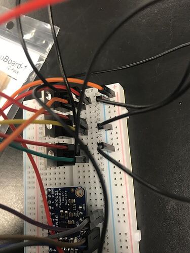

Prefacing this with: I'm very new to coding, and this could be a mistake in the code or something else entirely.
I'm using an Arduino Uno Rev3 to control an MPR121 Sensor, in hopes that when I touch the sensor, it will turn on LED tape, and when I release it, it will turn off the LED tape. I have used the MPR121 test code, which I have attached, to write my own code controlling the LED Tape through the Arduino. I've changed the code so that not only does it print in the Serial Monitor when I touch or release the sensor, but will also turn on or off the LED Tape in a controlled way. I've defined some of what I'm doing, but not all of it. The formula I'm using to control the LED tape is based off of this tutorial: PWM Exponential LED Fading on Arduino (or other platforms) | Diarmuid.ie
The troubles I'm having are:
The sensor is having difficulties sensing when I've released my electrode, and when I release it, it still does not turn off the LED tape.
