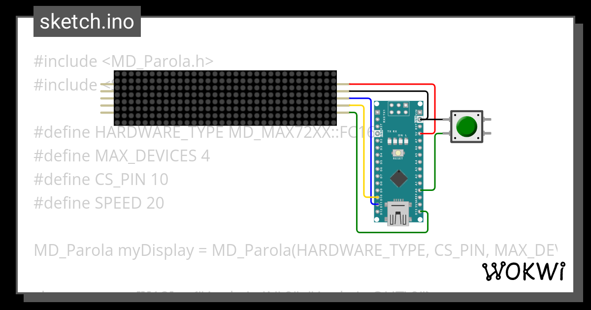

Using push buttons to display two different scrolling messages
I would like to use two buttons to alternate between two scrolling message on an LED Matrix display (Arduino Nano & Max72xx Matrix) can anybody help?

Would you consider using one button? I put your two character arrays in one two-dimension array. The button press changes states of the subscript to point to phrase one or phrase two...

This is the wokwi diagram.json
  "version": 1,
  "author": "Anonymous maker",
  "editor": "wokwi",
  "parts": [
      "type": "wokwi-arduino-nano",
      "id": "nano",
      "top": -137.2,
      "left": 174.1,
      "rotate": 270,
      "attrs": {}
      "type": "wokwi-max7219-matrix",
      "id": "matrix1",
      "top": -229.8,
      "left": -146.16,
      "attrs": { "chain": "4", "color": "cyan", "layout": "fc16" }
      "type": "wokwi-pushbutton",
      "id": "btn1",
      "top": -176.2,
      "left": 316.8,
      "attrs": { "color": "green" }
  "connections": [
    [ "matrix1:V+", "nano:5V", "red", [ "h115.2", "v67.2" ] ],
    [ "matrix1:GND", "nano:GND.1", "black", [ "h105.6", "v38.4" ] ],
    [ "matrix1:DIN", "nano:11", "blue", [ "h28.8", "v144" ] ],
    [ "matrix1:CS", "nano:10", "gold", [ "h19.2", "v124.8" ] ],
    [ "matrix1:CLK", "nano:13", "green", [ "h9.6", "v163.2", "h96", "v-28.8" ] ],
    [ "nano:A0", "btn1:2.l", "green", [ "h19.2", "v-77" ] ],
    [ "nano:GND.1", "btn1:1.l", "black", [ "h0" ] ]
  "dependencies": {}
This is awesome, thank you very much :heart_eyes:
There are better methods of reading a button... I used a poor example, but functional. Try to find and write two more sketches to...
  1. Read a button using "millis()" to "debounce" the pushbutton rather than "delay()"
  2. Read a button using a hardware interrupt (hint: with Uno/Nano, only pins 2 and 3 have hardware interrupts)
You will use pushbuttons very often in your projects. Ask questions when you need. Have fun learning.

This seems to work okay, I modified the Arduino 'Debouncing' example from the IDE and applied what I have learned to this project. I'm sure it can be improved but as a beginner I still have a lot to learn, what do you think?
Very good. Does the button behave as you expect?
Yes, it does, I am very pleased with the result, and have learned a lot, however I am now going to use this project to explore and learn about characters, strings and things and try to apply them to this project. Thanks for your help :grin::+1:t3:
